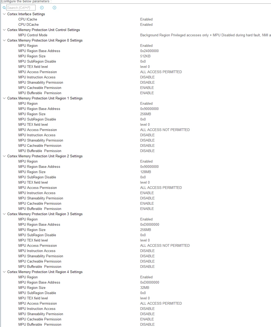

Hi, thanks for your quick reply. I m using custom PCB but same components in STM32H750. So i can say its H750 dev kit. But i m using a different screen (800x480). I got the touchgfx generated project for h750 cubeide and developed from there. Glitch happens every other screens as well. I did more toubleshooting and found out that, if i commented a variable defined in the model, glitch dosent happens.

H7 MCU means Cortex-M7 which means background optimizations such as instruction re-ordering, speculative accesses.
There are chances that these glitches are due to a wrong Memory Protection Unit (MPU) configuration.
The MPU allows to disable the Cortex-M7 optimizations, if the configuration provided in the Application Templates are fine for most cases they may not be on custom board, notably on external memories.
The consequences of a wrong MPU configuration goes from wrong data read (leading to display glitches for example) to hardfault...
Please have a look a the following MooC : https://www.st.com/content/st_com/en/support/learning/stm32-education/stm32-moocs/STM32_MPU_tips.html
As well as the following application note : https://www.st.com/resource/en/application_note/dm00272912-managing-memory-protection-unit-in-stm32-mcus-stmicroelectronics.pdf
To summarize you need to disable accesses to all addressable external memories (even not connected ones) and then define an area for each connected one taking care of how many masters can access the memory, if code can be executed or not, etc.

Thanks for your reply. This is my MPU configuration.
This is my memory definition.
MEMORY
 DTCMRAM (xrw) : ORIGIN = 0x20000000, LENGTH = 128K
 ITCMRAM (xrw) : ORIGIN = 0x00000000, LENGTH = 64K
 RAM_D1 (xrw) : ORIGIN = 0x24000000, LENGTH = 512K
 RAM_D2 (xrw) : ORIGIN = 0x30000000, LENGTH = 288K
 RAM_D3 (xrw) : ORIGIN = 0x38000000, LENGTH = 64K
 SDRAM (xrw) : ORIGIN = 0xD0000000, LENGTH = 8M
 ENV_VARIABLES (xrw) : ORIGIN = 0x90000000, LENGTH = 8K
 APPLICATION_FLASH (xrw) : ORIGIN = 0x90002000, LENGTH = 2040K
 APPLICATION_ASSETS_FLASH (r) : ORIGIN = 0x90200000, LENGTH = 126M
 BOOTLOADER (xrw) : ORIGIN = 0x08000000, LENGTH = 128k
Can you help me out to figure this out. Because I dont have much knowledge in MPU.

Hi, I had this issue and I solved it by reducing the LCD-TFT clock rate. In my case (using an F769I-Disco) I changed it from 41.7MHz to 32MHz. If your UI slows down, make sure your optimizations are turned on. Good luck.
(As a matter of fact, the 41.7MHz came from the 3.0.0 F769 application template, and 32MHz came from the 3.0.2 template)
