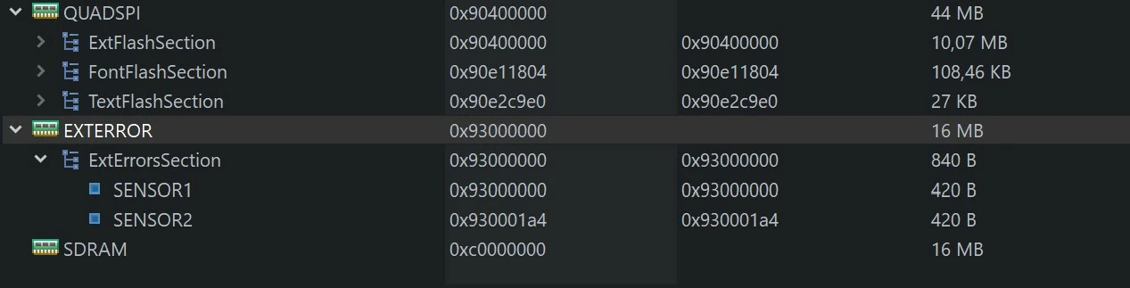

After building the code i can see at the Build Analyzer (i am using STM32CubeIDE) that the Memory Region "EXTERROR"  is filled with the table and at the Details i can see that the storing position at QSPI is "0x92800000".

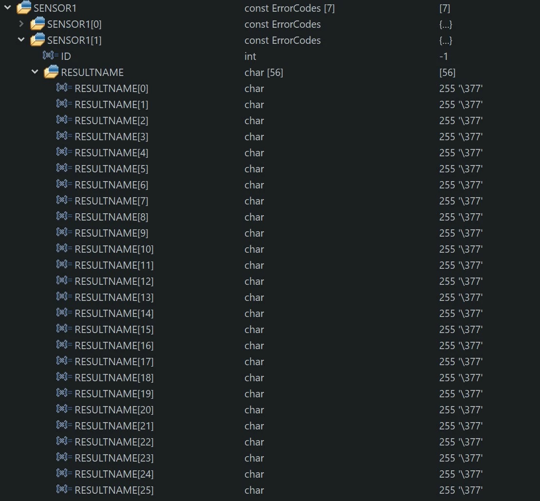

And when i try to read the SENSOR1 and copy it to "Errors", Errors is empty:
maxErrorsRows = sizeof(SENSOR1) / sizeof(SENSOR1[0]);
memcpy(Errors, SENSOR1, sizeof(SENSOR1));
At the debuger Live Expression i can see that "SENSOR1" is not filled. Screenshot attached.

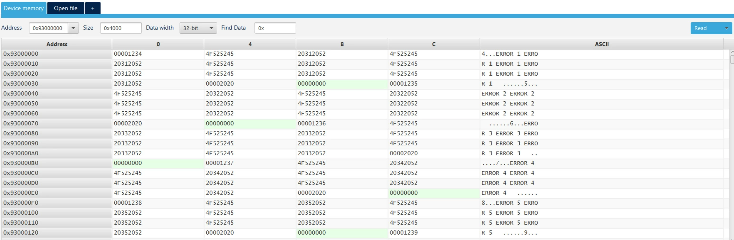

The Section is filled, from what i can see at the Memory Details, and when i check with STM32CubeProgrammer i see that "0x93000000" is filled with the correct values. Screenshots attached.
When i store it in flash, without "__attribute__((__section__("ExtErrorsSection")))" it works. SENSOR1 is filled with the correct values.
