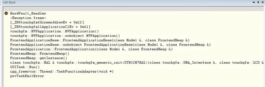

We need details about TouchGFX`s use of the crc module
Since version 4.10 TouchGFX needs the crc clock enabled to check if it runs on a STM32 MCU.
This worked fine for us so far.
Now we are adding other functionality to the application that require the use of the HW-CRC module.
Depending on how we configure the CRC module, we seem to run into some hardfault from within the TouchGFX initialization.0690X000006DlHdQAK.jpg
Please give us some information what TouchGFX will need to run.
Will TouchGFX do its checks only once or repeatedly?

Martin KJELDSEN
Principal III
Apr 29, 2019 7:50 AM UTC
Hi Alex!
Sorry, i'm not sure how i missed this. The trace you presented seems to be during startup of the application.
What exactly are you doing with the CRC engine that caused the lock to stop functioning? Are you using the CRC before or after TouchGFX starts? etc. Thanks!

Alex K.
Alex K.Author
Apr 29, 2019 8:56 AM UTC
Hi @Martin KJELDSEN​ ,
yes, the screenshot was taken when the app crased on startup. We are not sure what causes this crashes.
We are doing crc checks on chunks of Firmware updates before they are stored in flash.
We have secured our message queues with crc, which will use the CRC quite often as well.
And of course TouchGFX which we don´t know too much about...
We are using the crc also before the Touchgfx starts and also after. Of course, we use it more often after the touchgfx starts.
Thank you in advance!

Alex K.
Alex K.Author
May 22, 2019 7:34 AM UTC
i think we are through this at least for the moment.
There was a problem with our FreeRTOS Stack Sizes.
Can´t check often enough that Task size is in words and the FreeRTOS config is in bytes....
Some of our other tasks were growing fast, not instatiating the GUI Task helped, because it already had a big size.
So, issue solved.
Thanks again.
