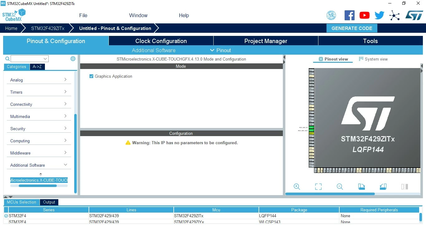

When i enable STM32-XCUBE-TOUCHGFX pack in my cubeMX software ; i have no parameter to configure but i got this warning : "This IP has no parameter to be configured" .
How should i solve this issue?

I think CubeMX is just letting you know there are no user-configurable parameters for that option. It's informational and not something that should cause problems generating or running code.

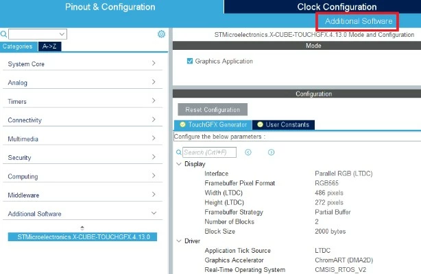

Normally, I should see something like this in configuration window :

​Hello @FKafi.1​ ,
This's a new behavior you mean ?  using which CubeMX version your latest screenshot ?

Hello @Khouloud ZEMMELI​ ;
No, it's not new. It's the first time i'm going to use this option.
My cubeMx version is 5.6.0.
Khouloud ZEMMELI
March 24, 2020
​Okey, I did not reproduce the issue so could you please share your ioc file?

Khouloud ZEMMELI
March 24, 2020
​Your project is ok, there's no problem.

Khouloud ZEMMELI
Khouloud ZEMMELIBest answer
March 24, 2020
​Try to re-install the cubemx 5.6.0 then re-check please.
FKafi.1
FKafi.1Author
March 24, 2020
Yeah. It works.
And also CRC must be enabled.
Thank you.
