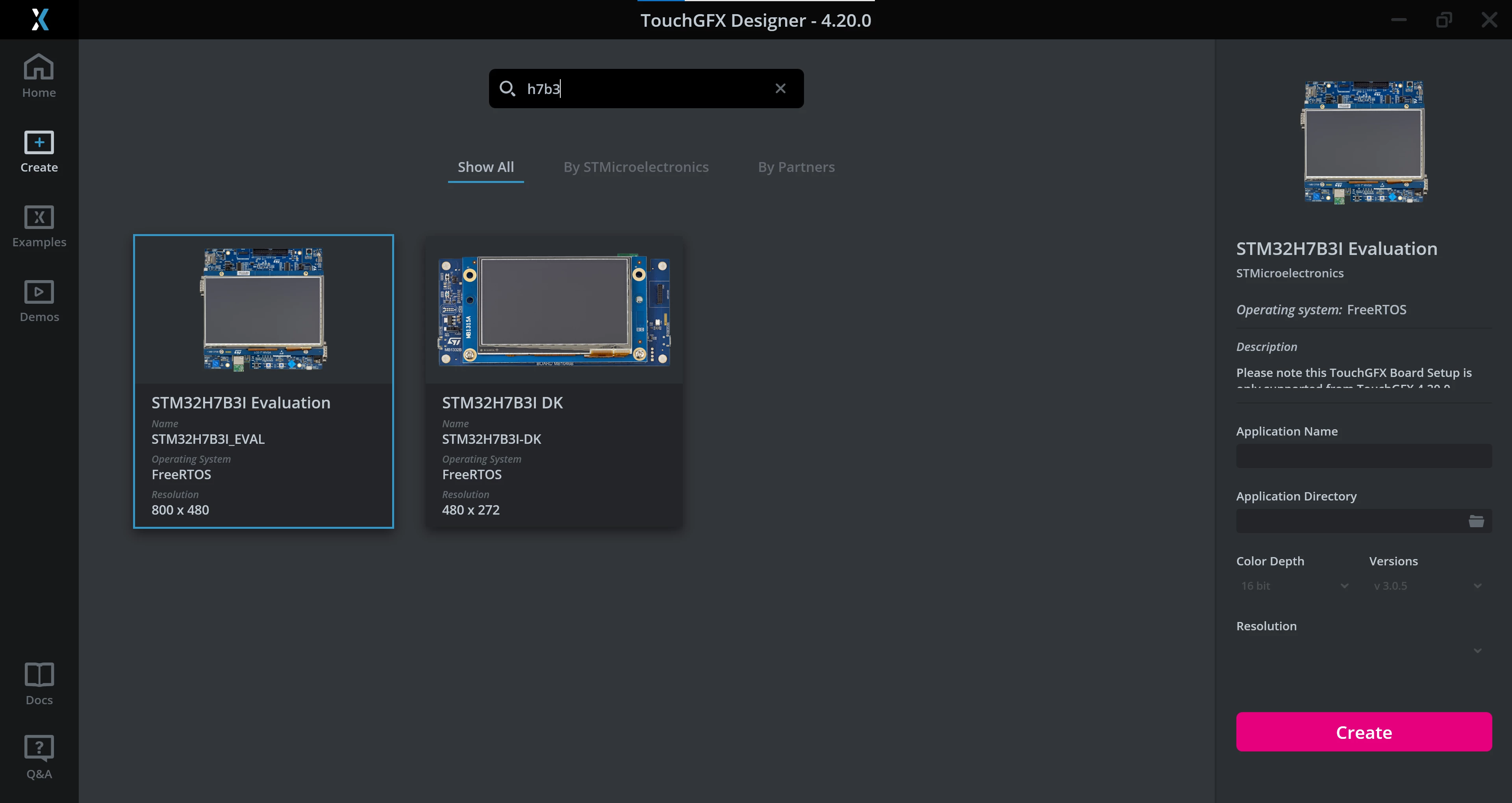

Hello @rozeelc,
I tried to replicate the project you have, but I didn't encounter the issue you mentioned.
Are you using the available TouchGFX Board Setup (TBS) for STM32H7B3I-Eval?
TBS for STM32H7B3I-EvalTBS for STM32H7B3I-Eval
I also noticed that in your debugger, no External Loader is selected. Do you still manage to start the debugger?

I'm sorry for the inconvenience. I managed to resolve the initial problem by selecting an External Loader. However, I now have another question and I hope you can help me.
