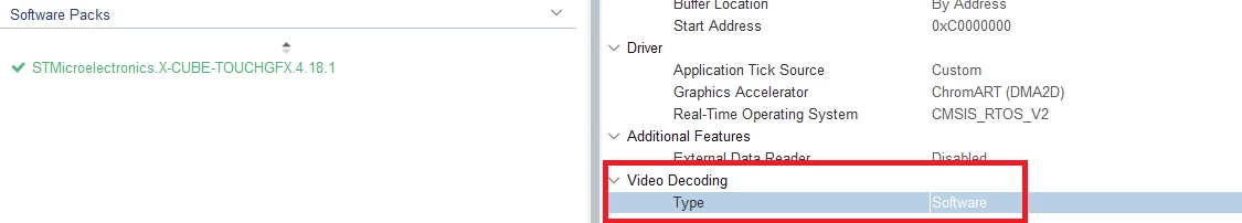

In CubeMx generator you need to:
1- Activate LIBJPEG in Middleware menu.
0693W00000HrVm0QAF.png2- Activate Video feature in Software mode from Software Packs menu:
0693W00000HrVmAQAV.png 3- Re-generate the code
Romain DIELEMAN
January 13, 2022
I'll just chip in to warn that there are more settings required within LIBJPEG and the Video Decoding section to be able to work with the video widget as stated in the documentation links I shared.
