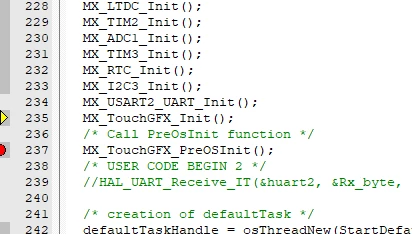

I have a horrible feeling I have done a similar thing. I had a program working fine and after adding to it, it would not compile (even when I removed the changes), so I ended up copying files into a new program (with the later Cube V6.81 / TouchGFX V4.21.4. It now compiles but gets no further than MX_TouchGFX_Init();
_legacyfs_online_stmicro_images_0693W00000bkC1GQAU.pngIt appears to finish at
_legacyfs_online_stmicro_images_0693W00000bkC2TQAU.pngin the TouchGFXGPIO.cpp program.
Most, if not all of this has been generated by Cube/Touch programs.
Incidentally, I don't know if it is related, but I also get this coming up consistently.
_legacyfs_online_stmicro_images_0693W00000bkC2JQAU.pngIs this likely to be related to updating Cube/Touch programs?
I foolishly thought working with the latest versions would be a good thing.

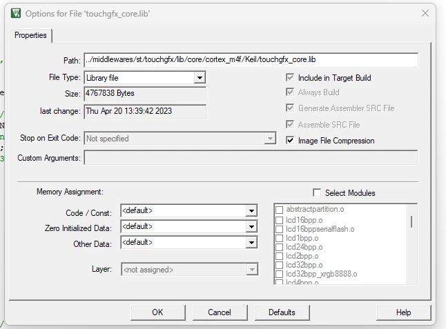

Derek, One issue I ran into during my upgrade was the project settings for the Linker had a Libraries search path that was picking up the wrong libtouchgfx-float-abi-hard.a file from the prior version of TouchGFX, make sure you are linking in the appropriate library.
derek2399
May 16, 2023 3:10 PM UTC
Thanks for taking the time to reply so quickly. It's much appreciated. I am using the Keil compiler and as far as I can tell, it appears to be use the same touchgfx_core.lib, which I think has the libtouchgfx-float-abi-hard.a within it ?? All the other project attempt's touchgfx_core.lib, have the same date 20-04-2023. I haven't seen any later versions, generated.
Please enlighten me if I am missing something or you feel something requires updating. I assumed it would just work and haven't much hair left to pull out.
