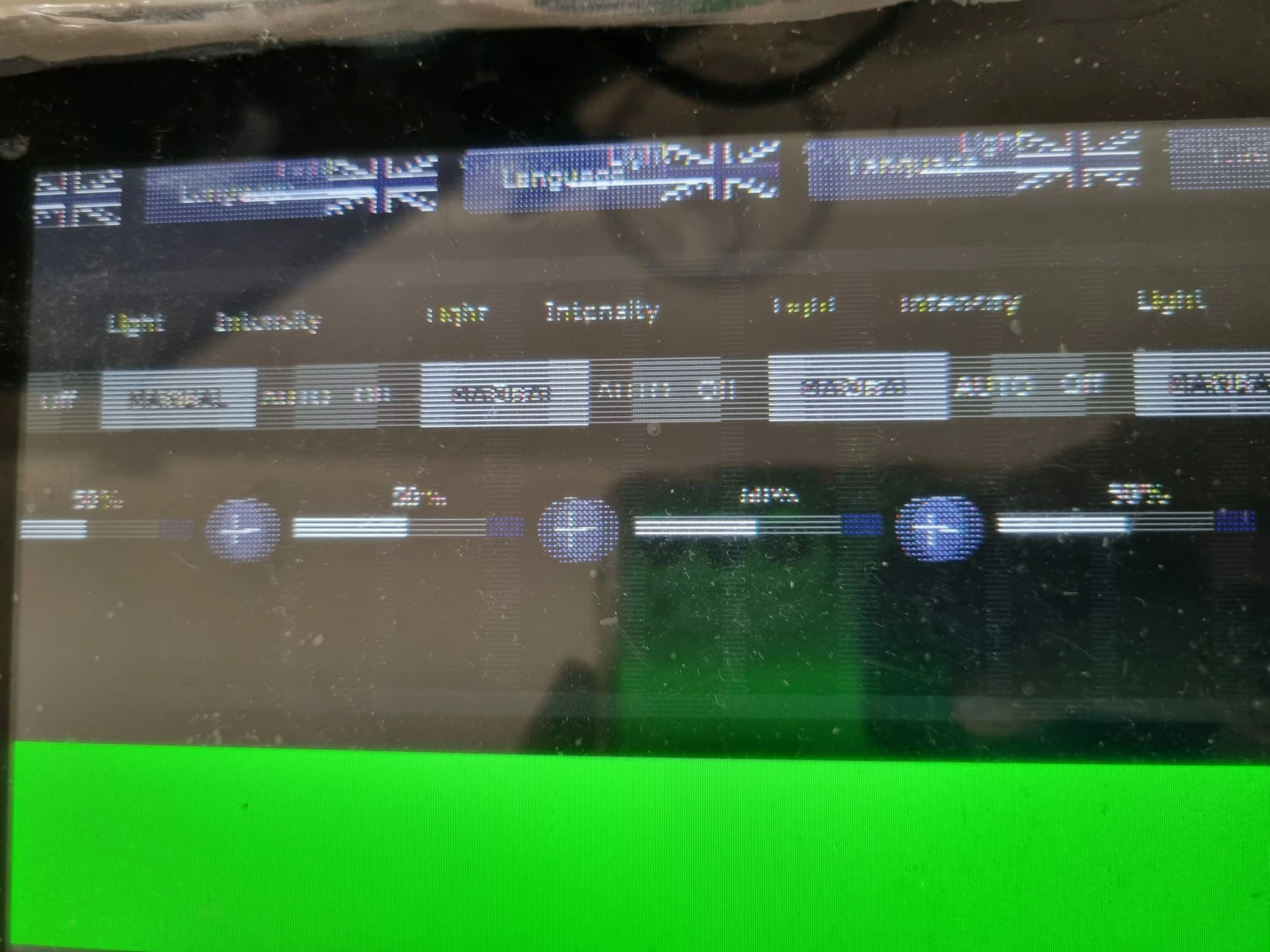

yuval
yuvalAuthor
December 27, 2021
Thank for your response.
I add below the display image .
It look I have some progress but still have to understand the repeated image below.
yuval
yuvalAuthor
December 27, 2021
0693W00000HppjbQAB.jpgThanks for you response.
I'm using LCD-MIPI example I found in forums for using video mode.
Also using some code parts from single buffer video mode ST example.
I changed the background to green and it look fine.
I'm using UTIL_LCD_Clear(UTIL_LCD_COLOR_GREEN); function.
Next, I'm using touchGFX.
The problem (seen in the picture attached), I'm getting a repeated graphics images.
when I'm using touchGFX with command mode (TE callback / not line callback)
and using ST display I'm getting fine picture.
I'm trying to think what I'm doing wrong.
Alexandre RENOUX
Visitor II
December 29, 2021
Hello yuval,
Testing with a single color without TouchGFX is a start but not enough to make sure your initialization is correct.
Are you sure your clocks are correctly set ? This could be a reason to this kind of effect.
For DSI Video Mode, clocks are very important. You can try to reduce the LTDC clock for instance to see if there is any difference.
You can also make sure your STM32TouchGFXHAL.cpp and .hpp files are the same (which means mostly empty) as an LTDC project like the TBS for F746-DISCO available in the Designer.
/Alexandre
yuval
yuvalAuthorBest answer
December 29, 2021
Hi ,
Finally the display is working as expected.
I had wrong configuration :
I changed
pLayerCfg.PixelFormat = LTDC_PIXEL_FORMAT_ARGB8888 ;
to
pLayerCfg.PixelFormat = LTDC_PIXEL_FORMAT_RGB888;
Than the display work as I expected.
(According to Display manual it work with ARGB8888 so I don't know why but touchGFX work when change back PixelFormat to RGB888 even simple image copy work fine with ARGB8888)
