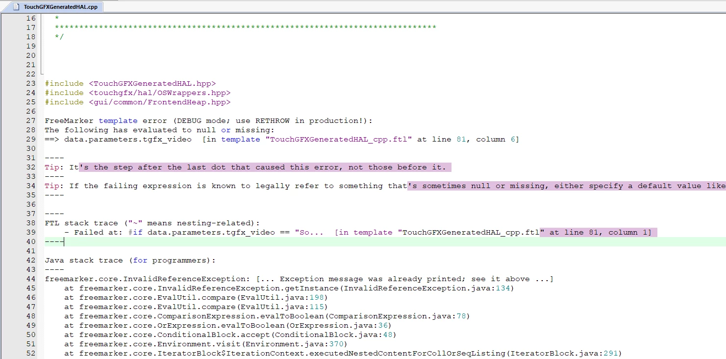

Using STM32CubeMX to create a TouchGFX project generates incorrect content
  • November 25, 2021
  • 1 reply
  • 1131 views
As the title, the file TouchGFXGeneratedHAL.cpp has some strange content, CubeMX version 6.30, TouchGXF version 4.18.Is there any solution?0693W00000GYojSQAT.png
