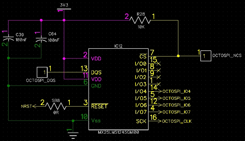

Using OCTOSPI with 4 pins. (IO[7:4])

I use MX25LM51245GMI00 flash. But I dont have few pins so I use 4 pins for OCTO SPI. Does it work 4 pins OCTOSPI? What do I it for 4 pins OCTOSPI. What changes do I need to make

I dont see quad-spi mode. This FLASH for octo spi. MX25LM51245GMI00 dont support quad-spi. :(

That chip needs all 8 data lines connected per the datasheet. It has a 1-bit mode and an 8-bit mode.

I am using below development tools
MCU: STM32H7B3IIT6
IDE: STM32CubeIDE Version: 1.8.0
GUI: TouchGFX Version: 4.18.1
SDRAM: IS45S16800F-7CTLA1-TR
FLASH: MX25LM51245GMI00
What it takes to adapt for QSPI. Can I use the following driver code for QSPI? How can I run it as QSPI.
March 3, 2022
Open up the datasheet for MX25LM51245GMI00. Do you see a quad-spi mode available?
