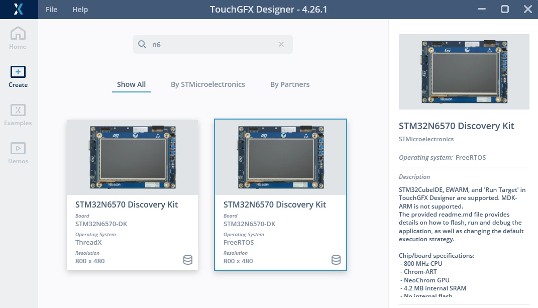

I need to speed up a image processing pipeline and want to offload image scaling to NeoChrom. It should be possible on STM32N6, however:
  1. I need nema_core.h and nema_graphics.h. I’ve downloaded TouchGFX via CubeMX, but I don’t see those files anywhere.
  2. I think, I need a /port/hardware config/ for STM32N6, but I don’t see any examples in https://github.com/STMicroelectronics/STM32CubeN6/tree/main/Projects/STM32N6570-DK
How should I proceed in this situation?

I would recommend you to install TouchGFX Designer. You can find the installer in the X-CUBE-TOUCHGFX package at STM32Cube\Repository\Packs\STMicroelectronics\X-CUBE-TOUCHGFX\4.26.1\Utilities\PC_Software\TouchGFXDesigner.
Once TouchGFX is installed, you can find the Nema includes for STM32N6 at C:\TouchGFX\4.26.1\touchgfx_components\gpu2d\NemaGFX_NemaP_m55_r01\include.
There are also two TouchGFX Board Setups (TBSs) for STM32N6570-DK available in TouchGFX Designer that can be used as references:
If you create a project based on one of these TBSs, you can find the Nema includes at Appli\Middlewares\ST\touchgfx_components\gpu2d\NemaGFX.
Using TouchGFX will also make it easier to receive future updates to the Nema library.
