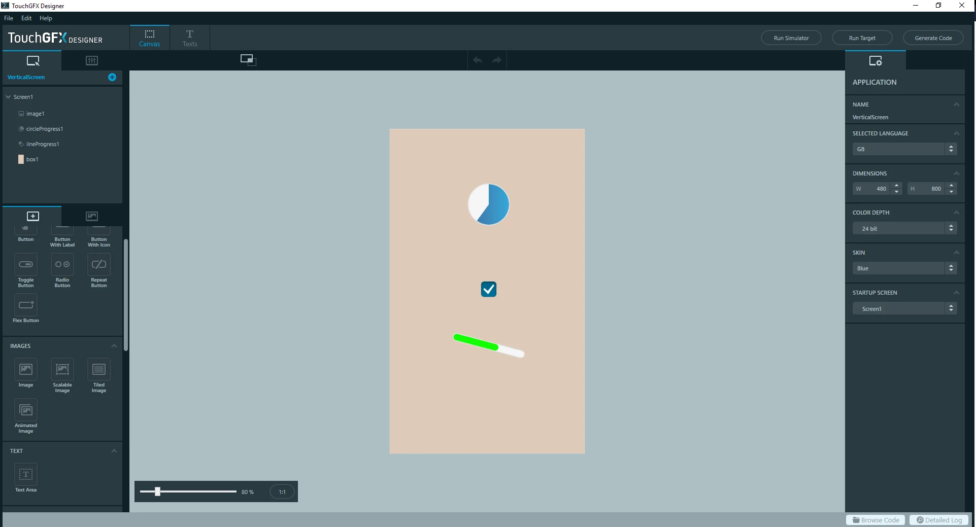

I'm gonna explain everything a bit better. So, what I want to do is to use the screen of the STM32F769I board in landscape mode. I created a default project with the template of that board in TouchGFX studio and then, I changed the dimensions of the screen so that it's now 480*800 and I dragged and dropped some widgets inside. It now looks as such:

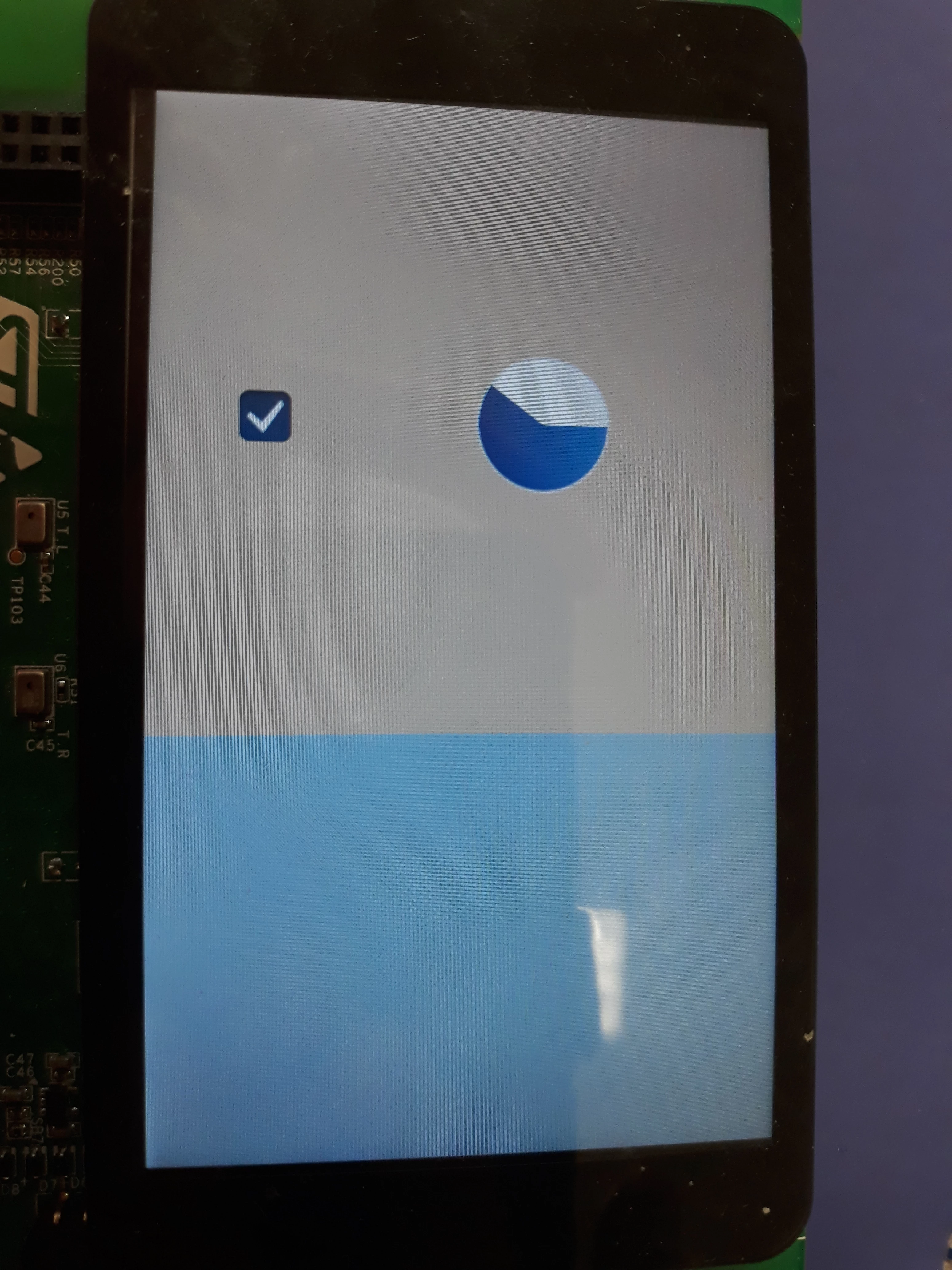

Now, I want to draw this exact screen on the 'real screen' but I'm unable to do so. I did what @qqAnton​ suggested (that is, add HAL::getInstance()->setDisplayOrientation(ORIENTATION_LANDSCAPE) in the function void GRAPHICS_MainTask(void) of the file BoardConfiguration.cpp and to change screen_orientation := -rotate90) and here's what I'm getting:
(The blue strip is from a previous screen). So it's clear that I'm not doing something right.
