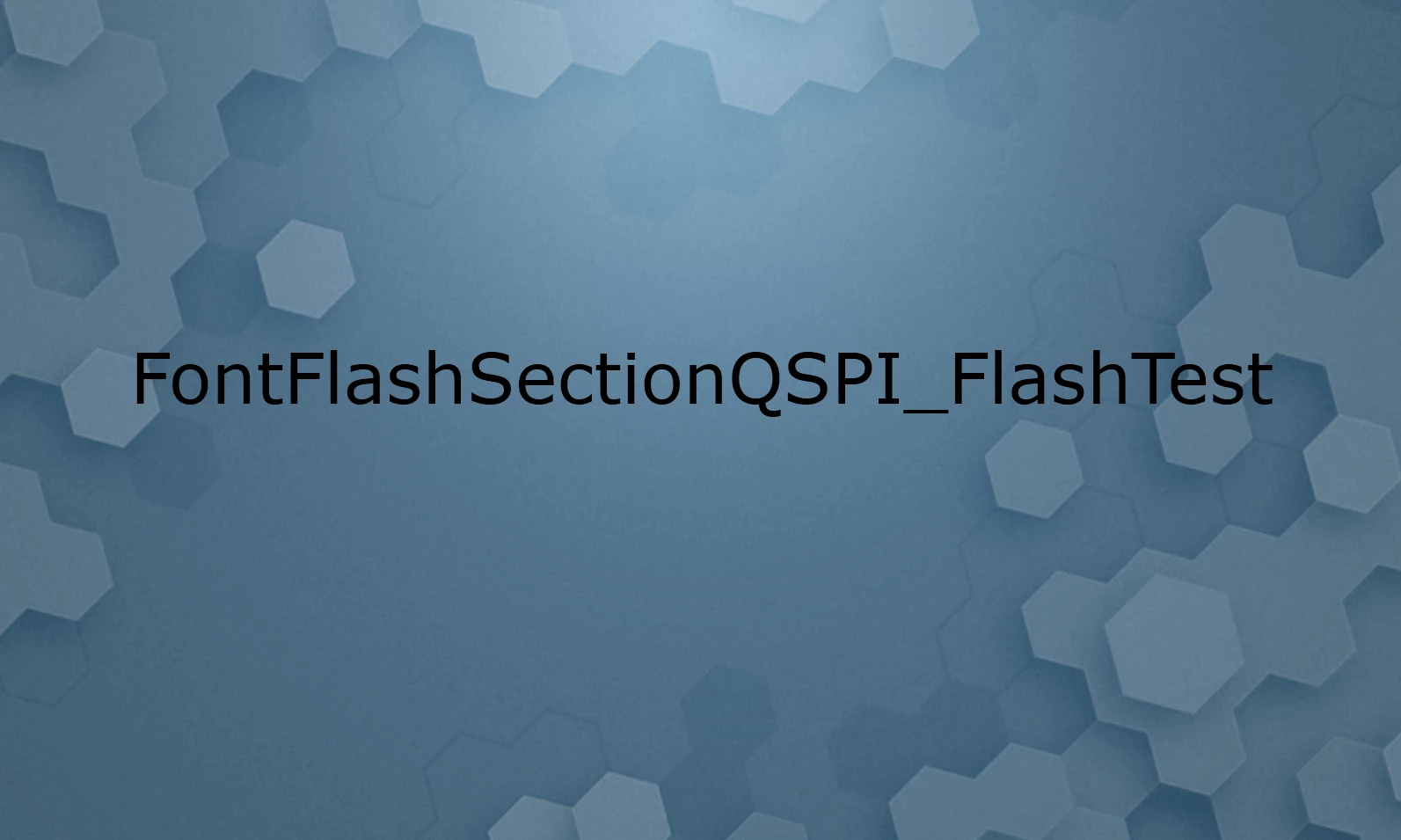

I've created a test touchGFX project for stm32h747i-disco by using TouchGFX Designer-4.21.4. It has only one screen that has one background image and one text. You can see it below:

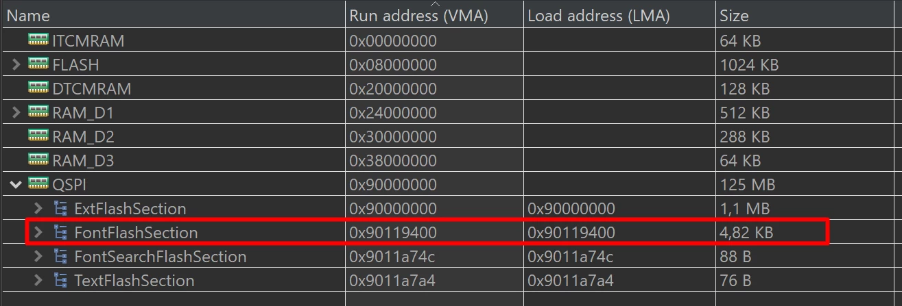

But when I write this linker code to move FontFlashSection into QSPI flash memory, it stucks in the ErrorHandler.
FontFlashSection :
	*(FontFlashSection FontFlashSection.*)
	*(.gnu.linkonce.r.*)
 . = ALIGN(0x4);
} >QSPI
ExtFlashSection, FontSearchFlashSection and TextFlashSection work in the QSPI flash memory without any problem. But when I add FontFlashSection as well to the QSPI Flash, the code somehow stucks in the ErrorHandler.

As i said, this sentence in linker script set in code address for reading fonts from RAM, but RAM is empty after sw start, because system loader not preload from QSPI. This must do your code in main before use fonts...
Simply after init QSPI memcpy fontsize area to ram choiced in ld.

Seems long problem based on somethink in lib and adressing in memory. Read FontFlashSection in memory mapped SDRAM - STMicroelectronics Community
And if your font info is short try store it in QSPI, but load into some RAM unused segment for example ITCM in linker script...

It works!!! Thank you so much :)
