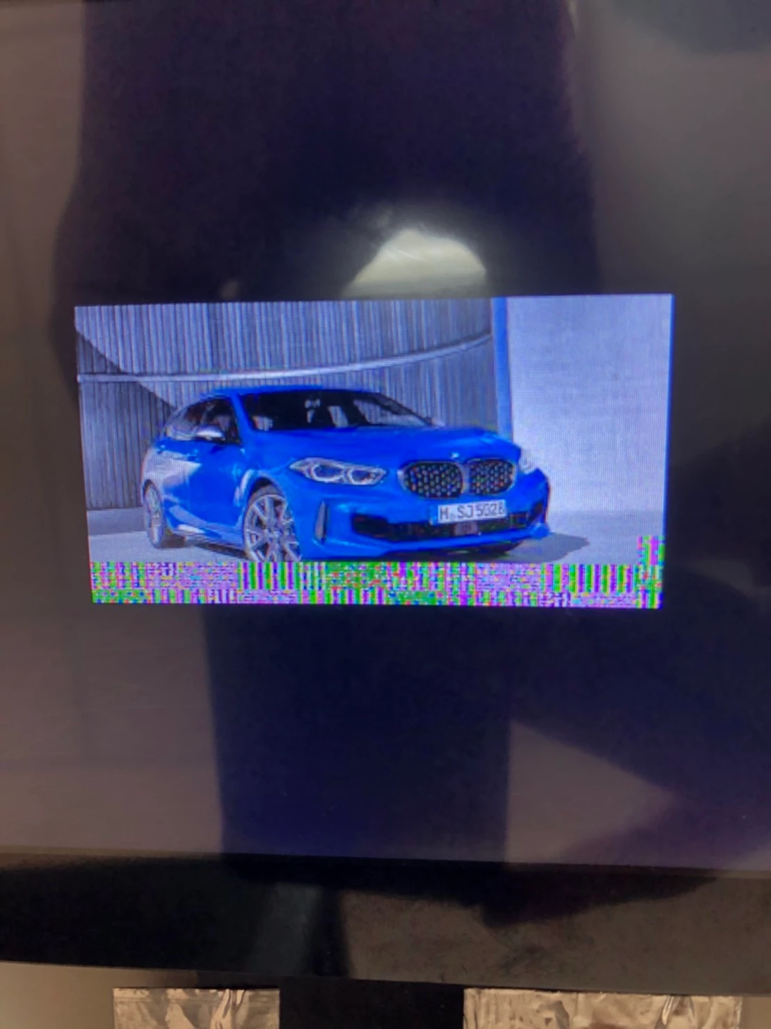

I`m trying to read the SDCard using FatFS and Decode the JPEG file then show on LCD, but I face some problem on it.
I reference the JPEG_DecodingUsingFs_DMA in STM32Cube_FW_H7_V1.5.0, and the detail code down below.
uint32_t JPEG_Decode_DMA(JPEG_HandleTypeDef *hjpeg, FIL *file, uint32_t DestAddress)
 uint32_t i;
 pFile = file;
 FrameBufferAddress = DestAddress;
 /* Read from JPG file and fill input buffers */
 for(i = 0; i < NB_INPUT_DATA_BUFFERS; i++)
 if(f_read (pFile, Jpeg_IN_BufferTab[i].DataBuffer , CHUNK_SIZE_IN, (UINT*)(&Jpeg_IN_BufferTab[i].DataBufferSize)) == FR_OK)
 Jpeg_IN_BufferTab[i].State = JPEG_BUFFER_FULL;
 else
 Error_Handler();
 /* Start JPEG decoding with DMA method */
 HAL_JPEG_Decode_DMA(hjpeg ,Jpeg_IN_BufferTab[0].DataBuffer ,Jpeg_IN_BufferTab[0].DataBufferSize ,(uint8_t *)FrameBufferAddress ,CHUNK_SIZE_OUT);
 return 0;
But it can`t show all pixels on the screen only a part of them,like limited by some parameters.
This is a official code from CubeMX.
Is there anyone can help to solve or similar experience can share?
Thank you!

Make sure the file data content reads correctly, and matches integrity checks from PC. ie CRC file/content, confirm it reads properly and consistently.
Try with multiple examples.

Hi @Community member​ ,
Thanks for your reply!
I have checked the data that read from FatFS with debug simulation, and it all correct.
But I can`t promise the output data in SDRAM and on Screen like the picture bottom pixel was not right.
Is there any method can check the problem?
