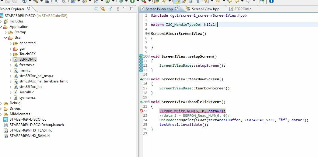

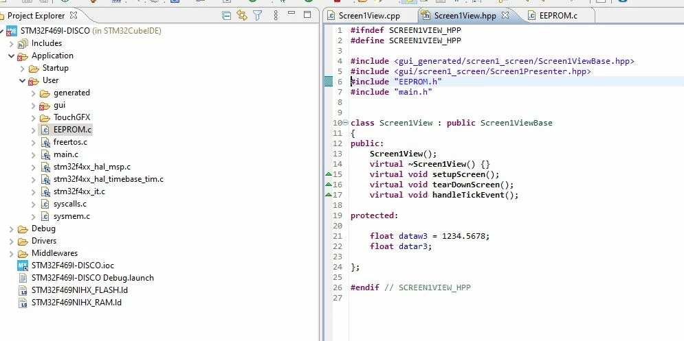

i´m new to TouchGFX and have some problems implementing a library for AT24C256 EEPROM.
Under the following link I found a library that someone makes available. I would like to use this and have integrated it into STMCubeIDE accordingly. If I want to call up the functions in the Screen1View, I get the error that there is no reference to this function. I suspect that I have packed the header file and the source file in the wrong folder. Where must even integrated files be stored correctly so that touchgfx can find them?

Error from​ compiler or linker?
If from linker make sure the library source files are visible in tree view.
Watch also for C/C++ naming and declaration expectations. ​

yeah it´s from linker, but my source file is visible in my tree view...
0693W00000D0DglQAF.jpg0693W00000D0DgvQAF.jpg 0693W00000D0DimQAF.jpgI´m a little bit confused about this problem :\

Use extern "C" declarations in your include file when playing mixed source types. Watch CPP name mangling.​

This solves my problem. Have forgotten the declaration totally.... :grinning_face_with_sweat:
Thank you very much, you save me a lot of time!
