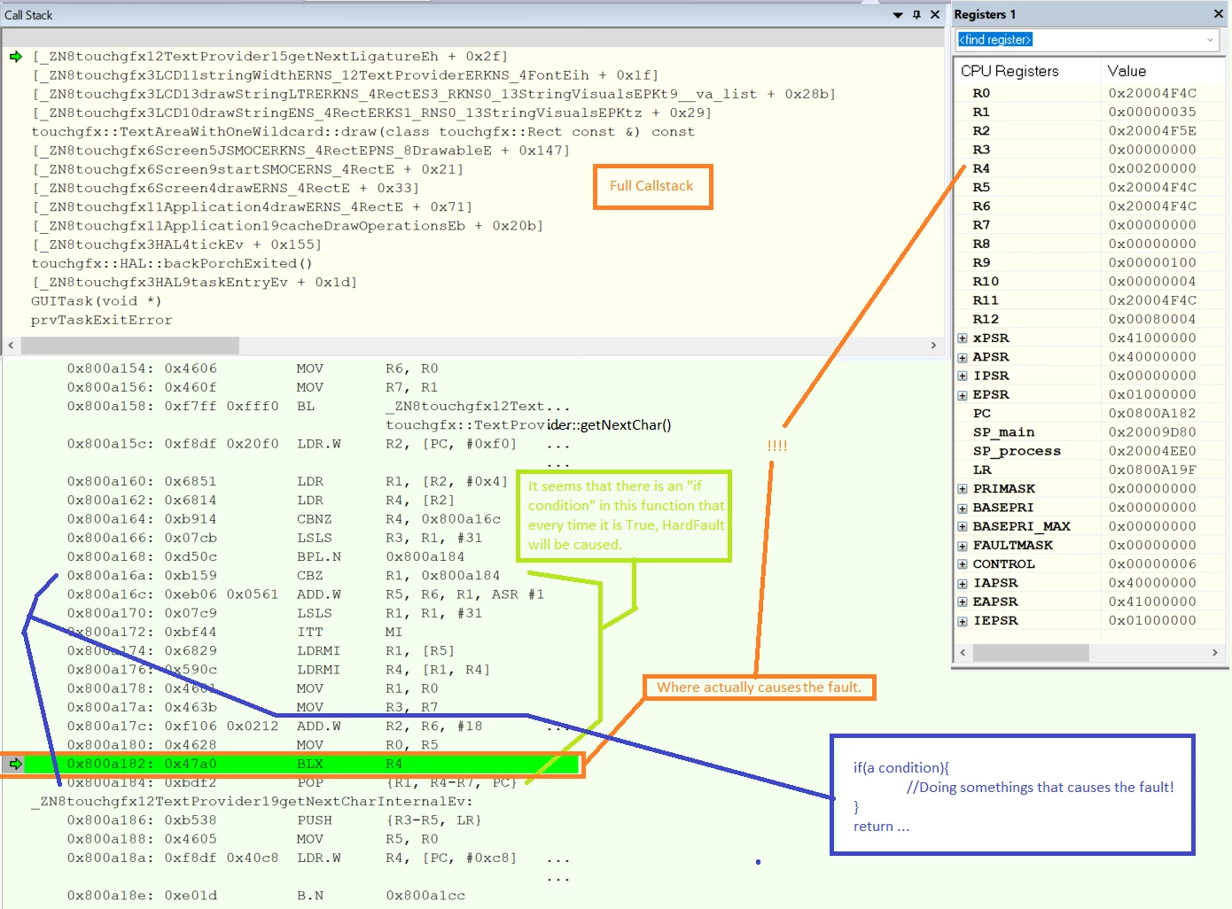

Using any type of text causes HardFault
I followed this guide (https://touchgfx.zendesk.com/hc/en-us/articles/115002741432-Create-custom-Application-Template) to adding TouchGFX to my existing project.
I'm working with IAR 8.30.1 and tgfx 4.10.0 and STM32F429ZG and FreeRTOS V9.0.0 ( with `heap_4.c` as memory manager ).
Everything works well now, except texts. Every time I added components that contain text, Hard Fault occurs during redraw (*.invalidate()) it.
I added
virtual void handleTickEvent() { container.invalidate(); }
to my ScreenView class to verifying DMA2D and LTDC configurations. All components work well. But existing just a text component causes HardFault.
By tracking `LR` and `PC`, I find out that HardFault occures in `TextProvider` class.
I think stack corrupted. Due to often times, `PC` is in the `DataSection`.
I increased the stack size of my GUI task and `configTOTAL_HEAP_SIZE` of FreeRTOS configuration, But results not changed. Is there any other stack size ( or heap size ) limitation?
Or, May I has been configured `BoardConfiguration.cpp`, `STM32F4DMA.cpp` or `STM32F4HAL.cpp` in a wrong way ?

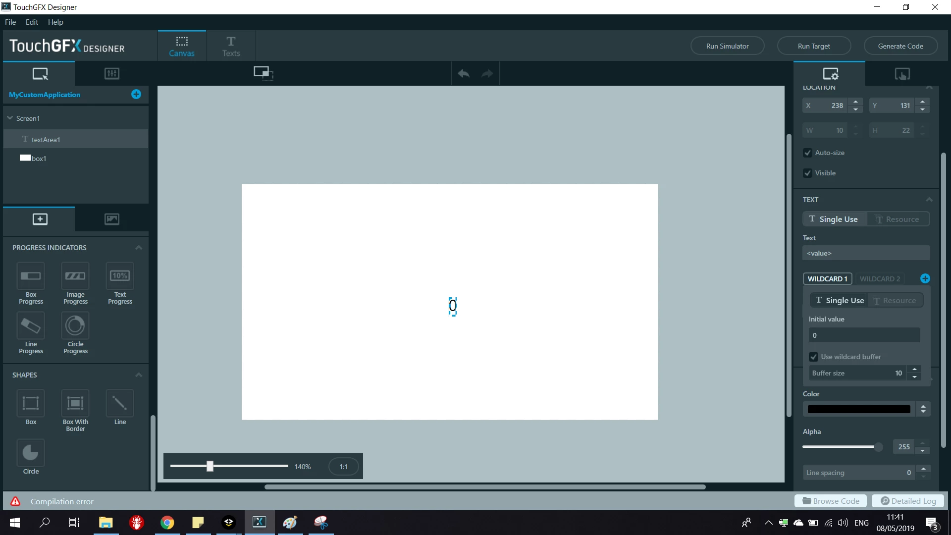

HMehr.14
HMehr.14Best answer
May 12, 2019
Thanks for your guides. My problem solved and everything works well now. I forgot to set the 'Wildcard Characters' and 'Character Ranges' parameters in the designer!

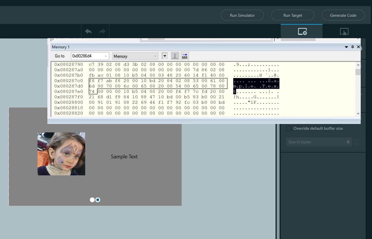

HMehr.14
HMehr.14Author
May 4, 2019
Generated text in the region of internal flash memory :0690X000008BH0rQAG.png
HMehr.14
HMehr.14Author
May 8, 2019
I'm sorry for disturbing you. But I couldn't solve my problem.
I tried with an alone text on my screen. More details below:

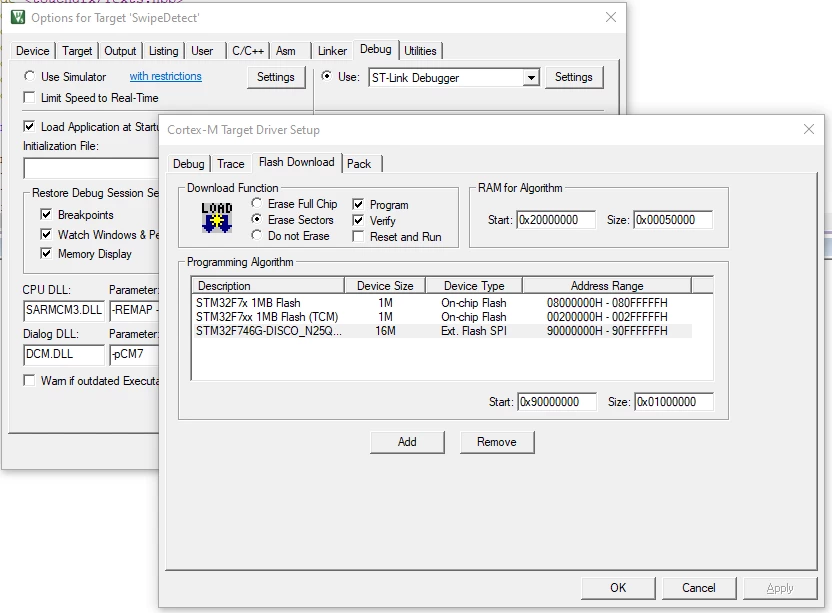

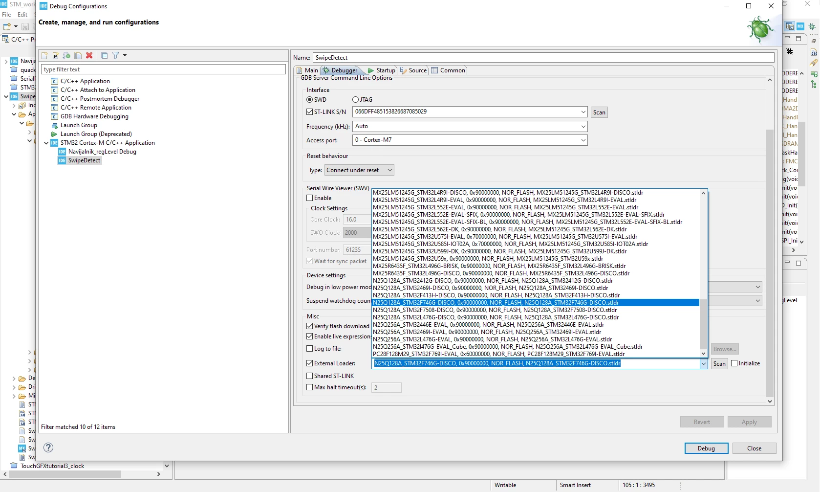

ZRego.1
February 6, 2021
Hi, had a same problem, took me hours to fix it. The reason is that some content (image and text is to be placed on external flash). To load onto external flash you need an external loader. CubeIDE, CubeProgrammer or Keil uVision are neither aware of that and you need to set it up manually, while TouchGFX Designer is apparently correctly setup to use external loader.
Keil uVision: Project Options -> Debug -> Use: ST-Link debugger -> settings -> flash download -> ADD -> find flash loader for your evaluation board or create your own loader -> set RAM size to 0x00050000, leave RAM adress unchanged.0693W000007ECiGQAW.pngSTM32CubeIDE:
Debug Configurations -> Debugger -> Scroll down and tick External loader -> Scan -> find appropriate loader for your eval board.
0693W000007ECifQAG.pngSimilar procedure on Cube Programmer and other IDEs.
@Martin KJELDSEN​ I think you should sincerely consider adding this note to Compiling and Flashing section of documentation, because it kind of prevents you from developing an application, as you cannot flash and debug from IDE. It took me hours to figure out the cause and not everyone is as stubborn as me :D
