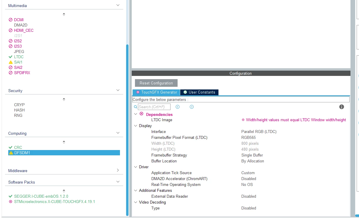

Updating TouchGFX from 4.13 to 4.19.1 through CubeV6.3 and getting error in TouchGFX about LTDC width and height dont match. I have tried to match all of the values set in LTDC but this error never fixes it. I couldnt find a tutorial that helped.

I found the answer, the frame buffer wasnt matching the window width and height.
