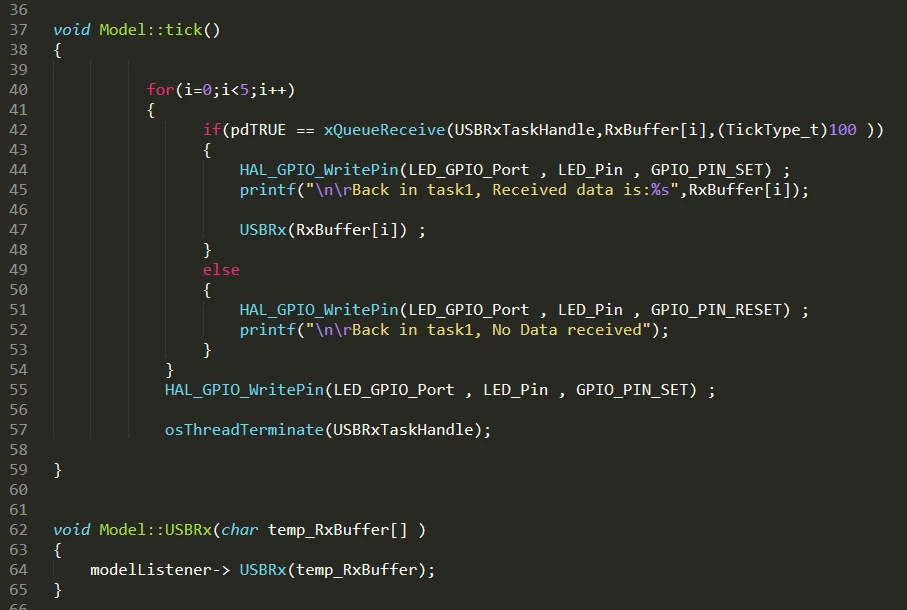

char TxBuffer[5][MaxElementsPerQueue]= {"LIST", "HELLO", "TouchGFX", "STM32F7", "SCROLL"};
if(pdTRUE == xQueueSend(USBTxTaskHandle,TxBuffer[i],(TickType_t)100 ) )
Same ways receiving in Model.c
void Model::tick()
		if(pdTRUE == xQueueReceive(USBRxTaskHandle,RxBuffer[i],(TickType_t)100
void Model::USBRx(char temp_RxBuffer[] )
	modelListener-> USBRx(temp_RxBuffer);

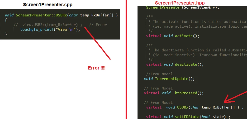

But Getting Error .. As below :

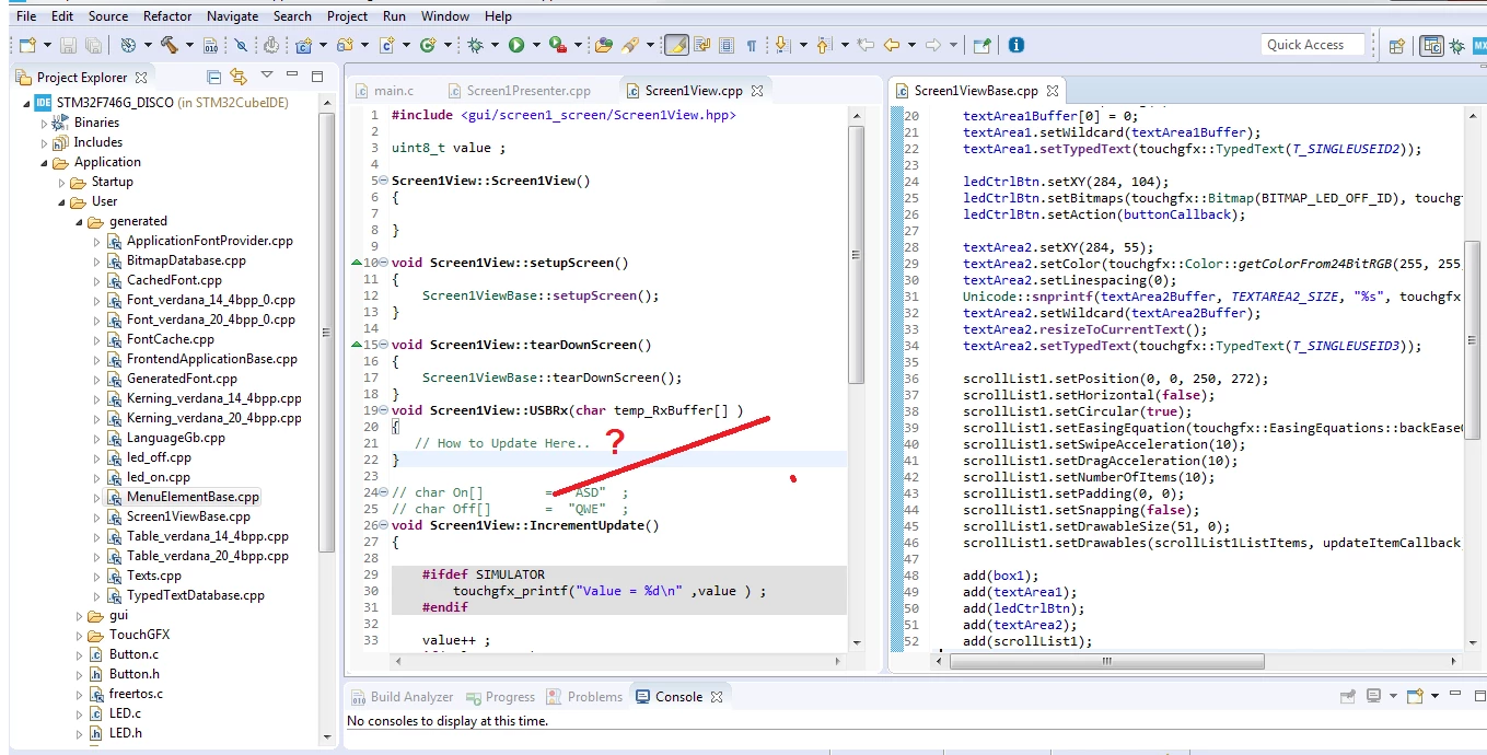

void Screen1Presenter::USBRx(char temp_RxBuffer[] )
	// view.USBRx(temp_RxBuffer) ; // Error
	 touchgfx_printf("View \n");
Is it right way ? Is there any application note or example for that .. ?

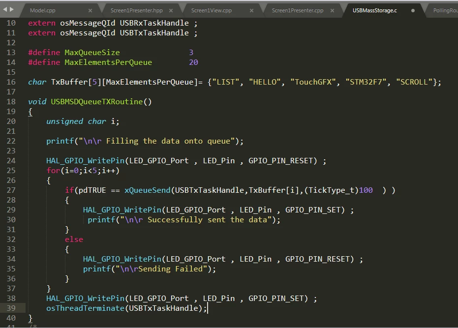

Hi @Community member​ ,
You have not specified what error you get. Further, I find that you are creating & terminating thread for Tx & Rx. Normally, that is not a good practice when you use an RTOS. You can block these 2 tasks, waiting for an event & let them be in the memory. In the long run creation/termination can lead to run-time memory issues.
As regards your error, can you share more information about it ?
/Jagdish

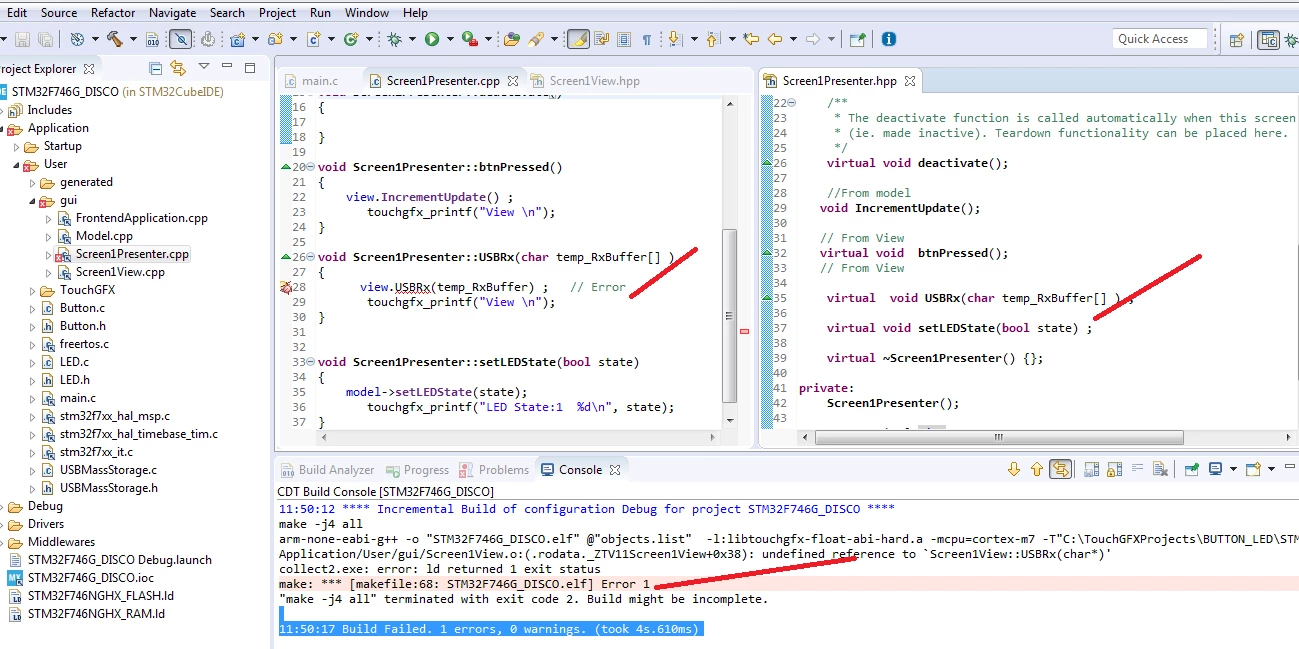

@Jagdish Bisawa (Community Member)
Please check the screen short for error ..
Apart from termination , Is is right way to move array information ?

Jagdish Bisawa
Visitor II
May 2, 2020 10:49 AM UTC
The error shown by you is a compile time error reported during the linker stage. This error means that the function USBRx(char*) has not been defined, i.e., the body of the function is missing. You need to define the body of the function in the .cpp file.
Regarding the thread termination, I suggest that you get familiar with RTOS workings. What I meant was that you can have USBTX & USBTx threads which will pass on the data using the queue & when they are done they can be blocked waiting for a semaphore. I am assuming that the USBTx thread will transmit data out of the USB port ( after receiving it from the GUI or another thread in the system ) & the USBRx thread will receive data from the USB port & send it further into the GUI framework.
/Jagdish

void Screen1View::USBRx(char temp_RxBuffer[] )
 // How to Update Here..
Am I do Correct Configuration for Scroll List in TouchGFX Framework.?
How to Update Here. in List Layout ?

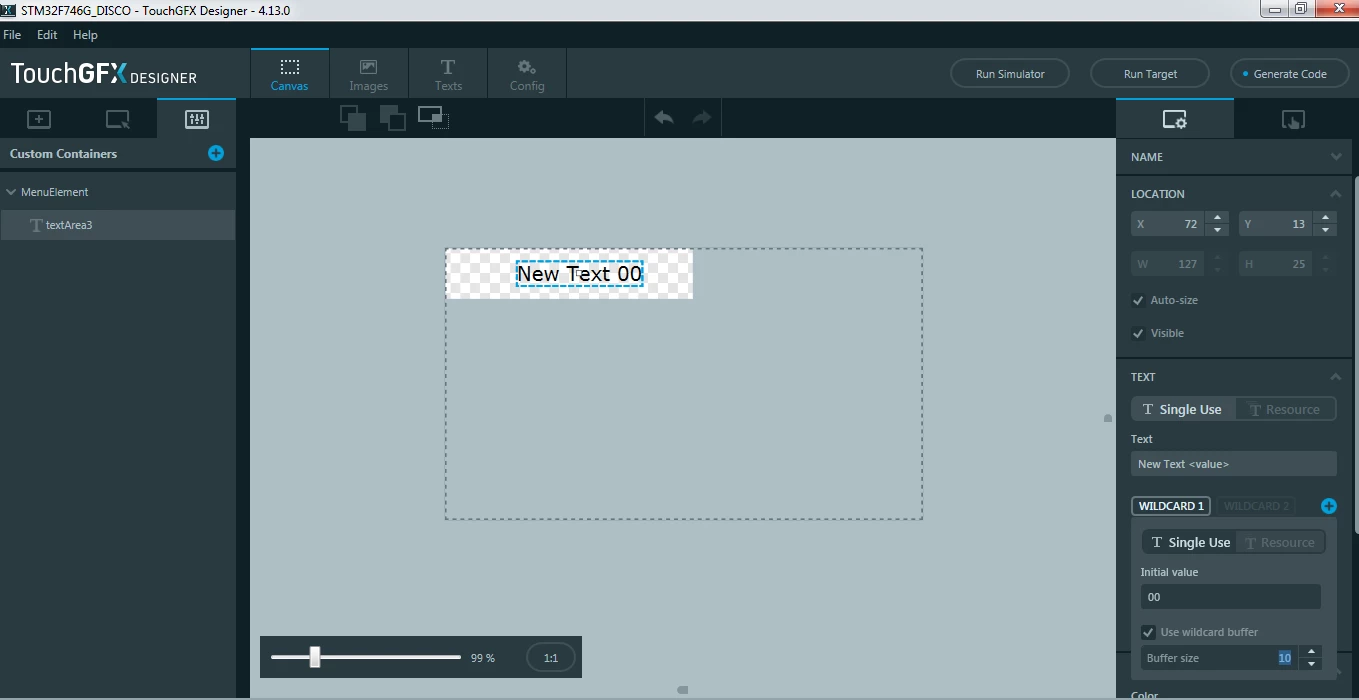

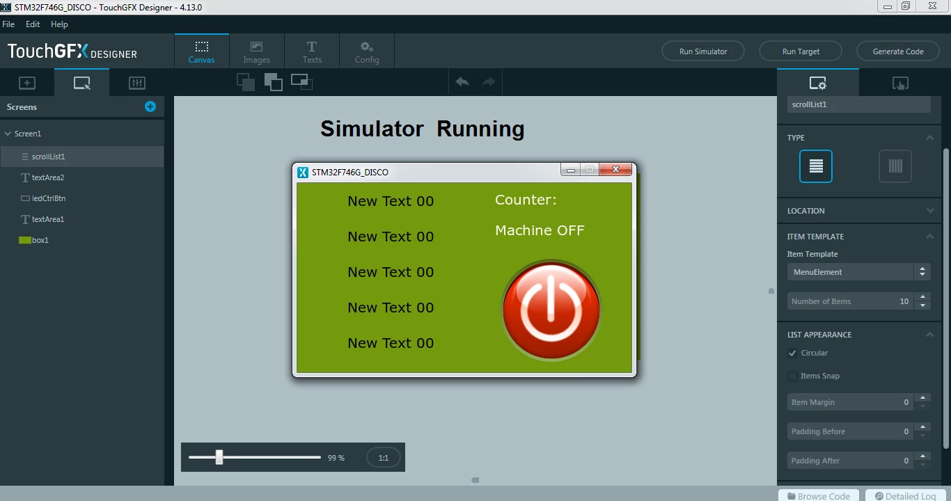

Yes , I want to Update "NEW TEXT 00" with
ln Screen1ViewBase.cpp .

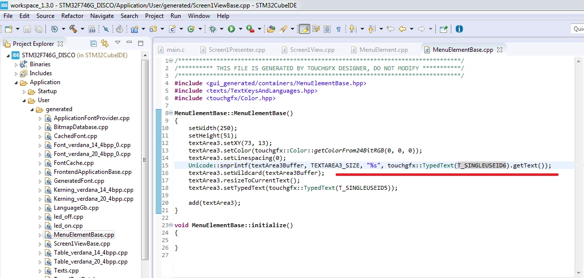

void Screen1ViewBase::updateItemCallbackHandler(touchgfx::DrawableListItemsInterface* items, int16_t containerIndex, int16_t itemIndex)
 if (items == &scrollList1ListItems)
 touchgfx::Drawable* d = items->getDrawable(containerIndex);
 MenuElement* cc = (MenuElement*)d;
 scrollList1UpdateItem(*cc, itemIndex);
ln Screen1ViewBase.hpp .
 virtual void scrollList1UpdateItem(MenuElement& item, int16_t itemIndex)
 // Override and implement this function in Screen1
I think I have to use concrete version of scrollList1UpdateItem in Screen1View.cpp.
 // scrollList1UpdateItem(MenuElement& item, int16_t itemIndex) ??
But could not find how to use here in
https://support.touchgfx.com/docs/api/classes/classtouchgfx_1_1_scroll_list
Am I right ? or any there API .

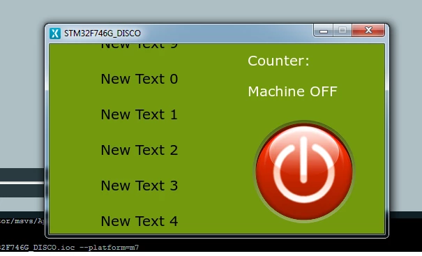

I am able to update "number" as per below tutorial
https://support.touchgfx.com/docs/development/ui-development/ui-components/containers/scroll-list
But still unable to update array .Also could not find any tutorials for that...
Please update if anybody have some idea.
