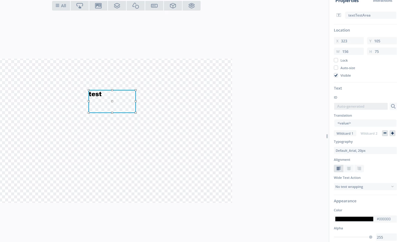

I am trying to update a text area called textTestArea with a string and I want to be able to format the string with a newline character.    Ex "I went to the store \n to buy food"
I created a texts called genericText that uses a default font that has wildcard range 0x00-0xFF ,  I also tried having range 0x20-0x7e and wildcard character 0x0A (/n)
here is the text and typography:
Here is the screen with text area:
in baseview.cpp it creates:
 textTestArea.setPosition(397, 26, 237, 55);
 textTestArea.setColor(touchgfx::Color::getColorFromRGB(0, 0, 0));
 textTestArea.setLinespacing(0);
 Unicode::snprintf(textTestAreaBuffer, TEXTTESTAREA_SIZE, "%s", touchgfx::TypedText(T_GENERICTEXT).getText());
 textTestArea.setWildcard(textTestAreaBuffer);
 textTestArea.setTypedText(touchgfx::TypedText(T___SINGLEUSE_E1ZC));
 add(textTestArea);
So now in my view.cpp:
	static const uint16_t TEXTBUFFER_SIZE = 64;
			Unicode::UnicodeChar textBuffer[TEXTBUFFER_SIZE];
		Unicode::snprintf(textBuffer, TEXTBUFFER_SIZE, "I went to store \n to but food");
		textTestArea.setTypedText(TypedText(T___SINGLEUSE_81C4)); // Must match your Texts View ID
		textTestArea.setWildcard(textBuffer);
		textTestArea.setWideTextAction(WIDE_TEXT_WORDWRAP);
		textTestArea.resizeToCurrentText();
		textTestArea.invalidate();
I get "test"  Not I went to the store....
I have tried 100 iterations.  I have gotten it to print "I went to the store \n to buy food", but can not get it to acknowledge the \n character.
How is this implemented correctly?

FJB2069
FJB2069Author
Senior
Jul 23, 2025 11:20 PM UTC
Could it be the font I am using dies not have the newline character defined?  I read something about creating special characters as glyphs?
FJB2069
FJB2069Author
Senior
Jul 24, 2025 1:57 AM UTC
I tried using vendana font, no difference.
So I am able to use this code and it prints a:
Unicode::snprintf(textTestAreaBuffer, TEXTTESTAREA_SIZE, "%s", "a");
 this is how the generated textTestArea is in viewbase.cpp
 textTestArea.setXY(397, 26);
 Unicode::snprintf(textTestAreaBuffer, TEXTTESTAREA_SIZE, "%s", touchgfx::TypedText(T___SINGLEUSE_J85U).getText());
 textTestArea.setTypedText(touchgfx::TypedText(T___SINGLEUSE_45YP));
 add(textTestArea);
But if I try to print  a \n a:  I get ??a
	Unicode::snprintf(textTestAreaBuffer, TEXTTESTAREA_SIZE, "%s", "a \n a");
   Not sure what to try?

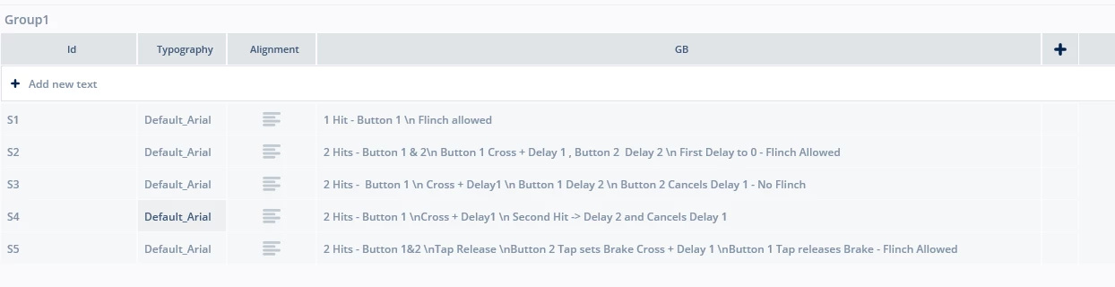

Could you use typed text in TouchGFX instead of programmatically assembling a multiline string? That's how I've been doing it, with no problems.
FJB2069
FJB2069Author
Senior
Jul 24, 2025 1:59 AM UTC
like this?
It still will not acknowledge \n
wait I can make it like this:
jchernus-fikst
Senior
Jul 25, 2025 3:02 PM UTC
Like that!

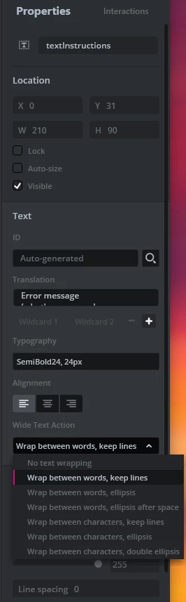

Another option is to add text wrapping to your text box, but I suppose you don't as much control around how it wraps.
Our text box is in a container,
And then our code chooses which of three errors to display (via custom title, image, and text) like so (sanitized version):

 // vertically center the instructions to the right of the image within its container
 textInstructions.resizeHeightToCurrentText();
 textInstructions.centerY();
 image.invalidate();
 textTitle.invalidate();
 textInstructions.invalidate();
