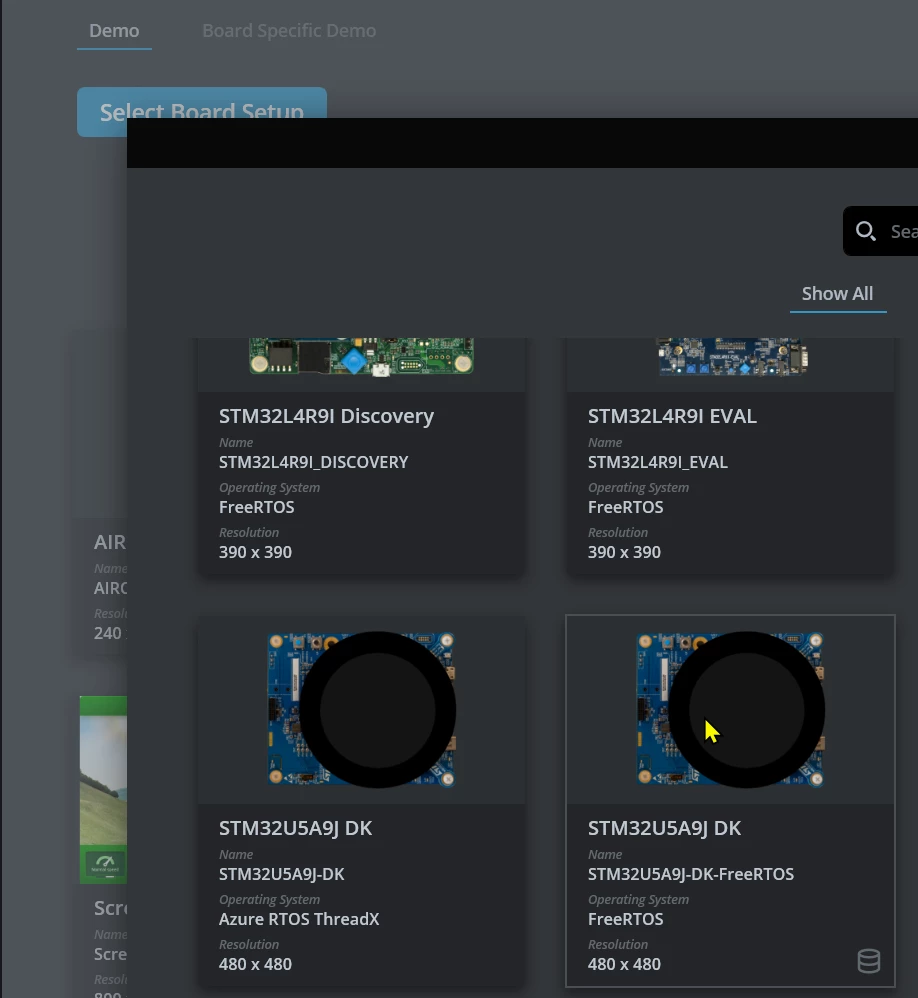

Under TouchGFX designer application there is an advertisement touting "STM32U599 fully supported" with an image of the kit with the rounded display. I got the kit from ST (STM32U5A9J-DK / DK32U5A9J$AT1) with the STM32U5A9, with the same round display.
Contrary to some other "board demos", this demo only works with the simulator. Maybe that's the reason why it's only present in the first tab named "demos", and not within the second tab "board specific demo".

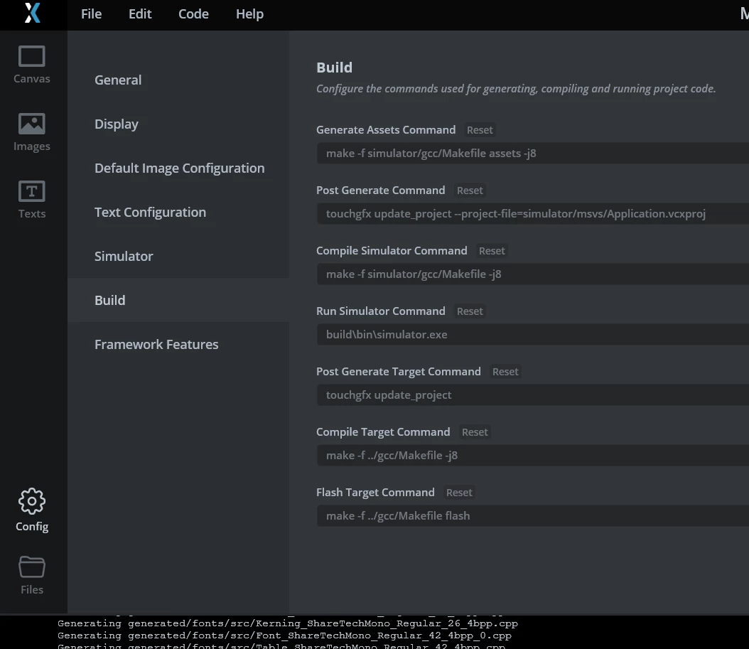

In the build section of the demo named "TouchGFX demo 6", which is exactly the same application running on the kit, there are no instructions to build and upload the demo to the target.
How to solve this? Any hint?

    I solved this issue.
    You have first to select the matching board setup (so the kit I mentioned)
    and then you have reduced set of demos presented for the board.
    And here I could select the demo 6 and the build configuration for the target was correctly set then:
    Hope it can help someone else.
