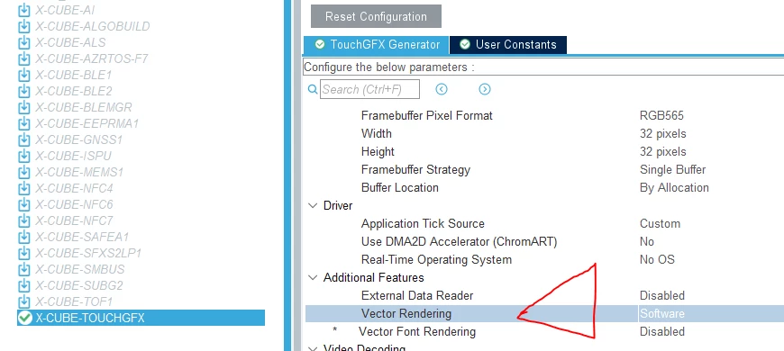

undefined reference to `touchgfx::VectorRenderer::getInstance()' after adding a SVG image?

so I compile and run the code with no SVG images, and it works perfectly. I then add in a svg image using the touchGFX designer, using the svg image widget. the image im using is the stock touchgfx image, and when i try to compile, i get this error.

Not sure if I remember I had the same error, isn't it related to enabling it in MX ?
