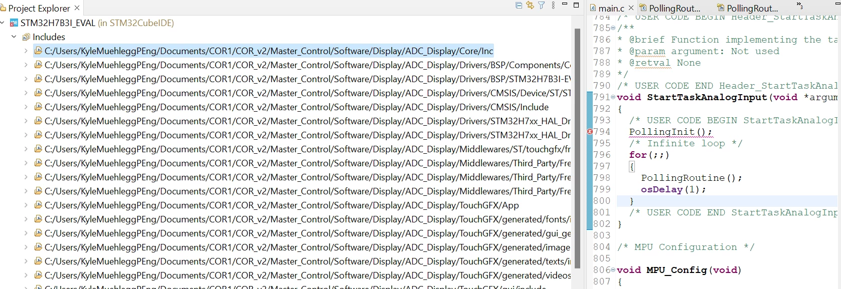

"Undefined reference to custom function" but header is part of the includes path.
I am writing firmware that was automatically generated by the TouchGFX 4.20.0 and then opened the .ioc file to enable an ADC, Timer, Binary Semaphore and add a Task. When I generated that code, it compiled without any issue.
My purpose for enabling these features is to measure the value on an ADC and display it on the LCD screen.
Part of my work was to develop a custom .c and .h file that initialized the ADC, the timer and do a callback to send the ADC value to the screen via a Binary Semaphore.

When I compile, I get an error of "undefined reference to PollingInit() & PollingRoutine()"
The PollingRoutines.h header file is in the project's includes path. Specifically, in the one highlighted:
I'm unsure what's causing this error, since PollingInit are defined in PollingRoutines.h, which is in the project's included paths. Did I miss something?

Resolved the issue.
Despite the Core/Src folder's PollingRoutine.c, you ALSO have to include it in the Applications/User/Core folder, or the project compiler does not recognize it. When I added it, the error went away.
