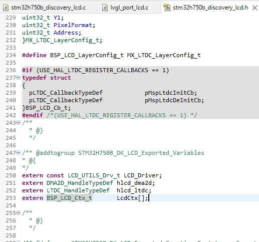

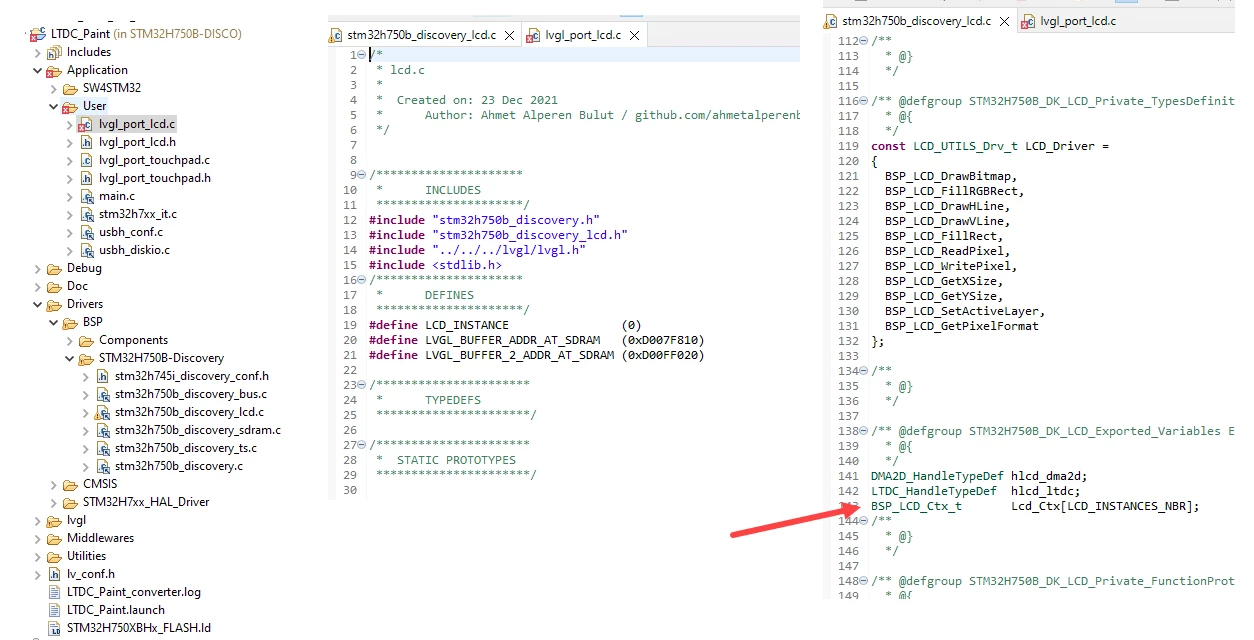

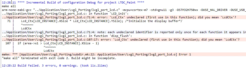

I am going crazy, I always get the error that the structure Lcd_Ctx is not declared, while it is clearly declared (by including "stm32h750b_discovery_lcd.h").
With F3 I can find the structure declaration.
If I change the file from .c to .cpp the error is gone...
See screenshot below:
pk84
pk84Best answer
Oct 21, 2022 12:27 PM UTC
oh, now I see the problem, thank you.
In the 745 h-file the variable is declared with extern Lcd_Ctx, and in the 750 h-file with LcdCtx ...

Sorry , but you dont show where you declare Lcd_Ctx not type , but object. Try show code part.
pk84
pk84Author
Oct 20, 2022 2:36 PM UTC
here:
Bob S
Oct 20, 2022 3:05 PM UTC
There should be a .h file with an "extern" declaration for that variable (maybe in stm32h750b_discovery_lcd.h). Make sure that you include that file in your lvgl_port_lcd.c file. If there isn't an "extern" declaration somewhere, you need to add one.

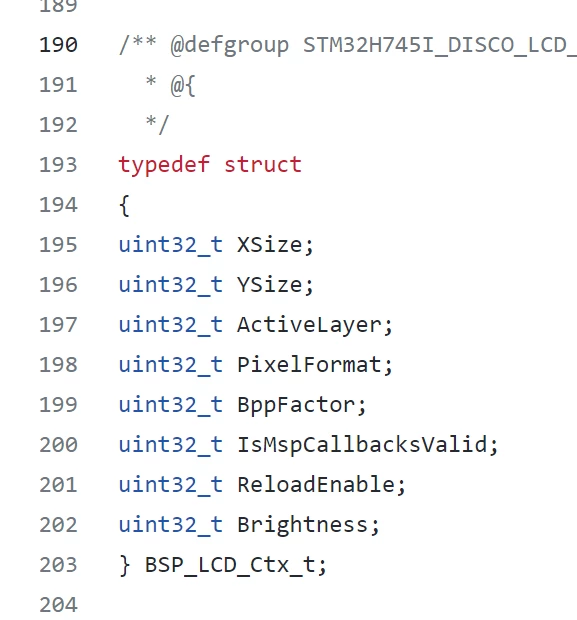

In following code there is no "extern" declaration, see link/screenshot below.
I just copied the files into my code, and if possible I don't want change something in these files.
Why do I need it in my code this "extern" but in the mentioned/linked code there is no "extern" declaration? How can I do it the same way?
https://github.com/lvgl/lv_port_stm32h745i_disco/blob/master/CM7/Drivers/BSP/STM32H745I-DISCO/stm32h745i_discovery_lcd.h

I see it on github line 234 ... , but this all is simple C rules .

Hello, I think that it finds your structure but not your variable, in the file where you want to use your variable you must write extern BSP_LCD_Ctx_t Lcd_Ctx[LCD_INSTANCES_NBR] because the variable is not declare in the same file.

I think it's in stm32h745i_discovery_lcd.h, line 234: "extern BSP_LCD_Ctx_t Lcd_Ctx[];"
then he calls his .h in his .c file

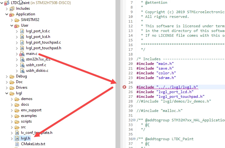

I have another similar question:
Why the compiler does not find lvgl.h, see screenshot below:
Senior
Oct 21, 2022 1:54 PM UTC
You need to write #include "../lvgl/lvgl.h" because ../ means exit the folder where your .c is.
So you exit User then lvgl is in the same level
Senior
Oct 21, 2022 1:56 PM UTC
Ok maybe I don't see well the picture, there is an other possibility
