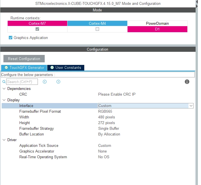

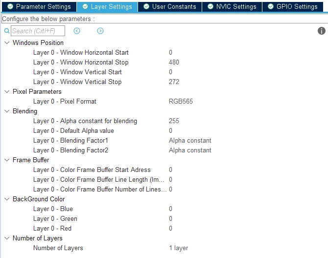

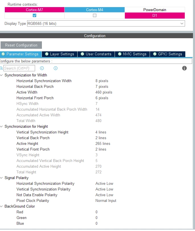

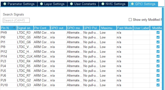

Within TouchGFX Generator the Display/Interface selection only allows Custom and Parallel RGB(LTDC) is grayed out. LTDC appears to be enabled correctly? See pics below:
How can I select the LTDC Interface? I'm using CubeMX 6.1.0, MCU Package for STM32H7 Series 1.8.0, and TouchGFX 4.15.0
Thanks.
TouchGFX Generator:
LTDC:

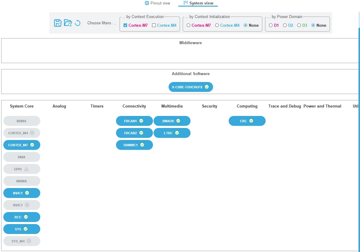

N. SANTINI
November 24, 2020
Are you sure that the LTDC is enabled on the same core (M7 in your case) ?
Best regards,
Nicolas
GTrei.1
GTrei.1Author
November 24, 2020
@N. SANTINI​
Hello Nicolas,
Yes it is on the M7 core as shown below. I also attached my project file.
Regards,
Gary
N. SANTINI
November 25, 2020
You are right, I am able to reproduce it starting from scratch.
This is the first release of the Cube Expansion Pack support for dual core platform in CubeMX there may still be some bug remaining.
Sorry for the inconvenience, I already reported the point to the R&D team internally, I will come back to you (or maybe a R&D team member will answer) as soon as I get a feedback.
Best regards,
N. SANTINI
November 25, 2020
Dear Gary,
Unfortunately after an internal cross-check (with the TouchGFX team) the support of Cube Expansion Pack for dual-core is only a pre-requisite for TouchGFX Generator.
The TouchGFX generator does not officially support dual-core platform and should not have been allowed to be enabled in CubeMX 6.1.0.
So for the time being you cannot configure TouchGFX in CubeMX for a dual-core MCU, you should instead use either the TouchGFX Designer application template for H747 (same as H745 with security features on top, migration should be easy) or the H7 Cube Firmware examples.
Best regards,
Nicolas
