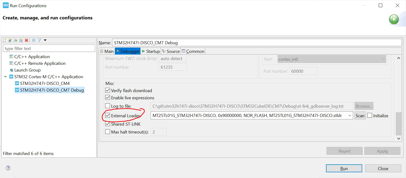

Problem 1 - Flash Touch GFX App via Cube IDE
A previously imported Touch GFX project cannot be brought onto the target using the Cube IDE.
Problem 2 - TouchGFX UI with TextBox
As soon as I insert a textbox with text in TouchGFX, it is not possible to run the generated code on the target.
This means that it is not possible for me to develop an UI application using the mentioned tools.
I would be pleased if someone could point me in the right direction to solve the problems.

Details for Problem 2:
Same TouchGFX Designer project. Just added a screen centered textbox with text.
Step 1) Generate code
=> ok
Step 2) Run Simulator
=> ok
Step 3) Run Target
=> fail
console shows...
    Error: failed to download Segment[2]
    Error: failed to download the File
Display stays black.
I also observed in another test a distorted display image.

One day off to think... :)
The hardware architecture of the board contains external flash memory.
This is used to store texts, fonts and images of a TouchGFX application.
The root cause of the error message Error: failed to download Segment as well as the Cube IDE error message did not become relevant in the first test, because neither texts, images nor fonts were used.
Only in the second test (with a simple text) it is necessary to feed the external memory with data.
In other words... I just forgot to use an external loader when flashing.
After I configured the appropriate External Loader in Cube IDE, the download works fine.
However, one issue remains.
I did not find a way to specify an external loader within TouchGFX Designer.
Therefore it is not possible for me to flash the firmware using the designer.
However, this is not a big deal for me.
