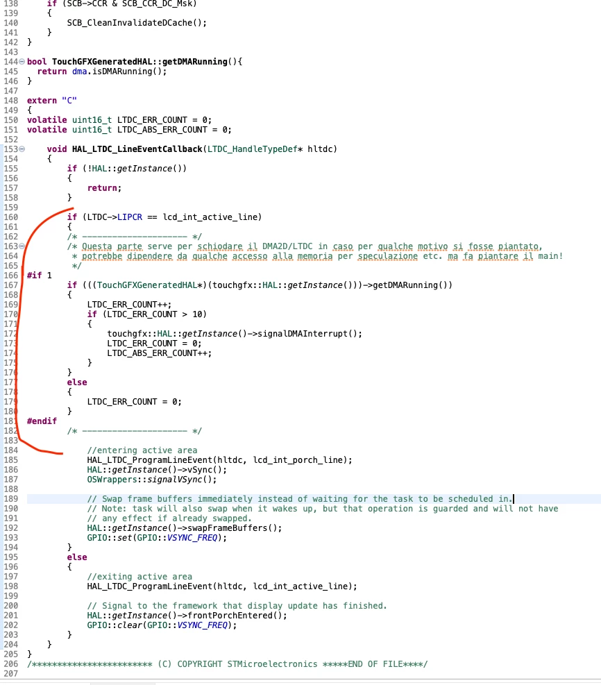

Gents, I experimented same problem, with TouchGFX 4.20 in a custom board with STM32H723 and external FLASH and SRAM. The first thing I've done has been to implement a routine, like I saw in a comment here, to unblock in any case the touchgfx. In practice, in case the DMA doesn't report a "transfer complete" and get stuck, a timeout is triggered and the effect is a "lag" on the screen, but not a complete freeze that must be avoid in a final product. See image here attached of the modification in TouchGFXGeneratedHAL.cpp...
