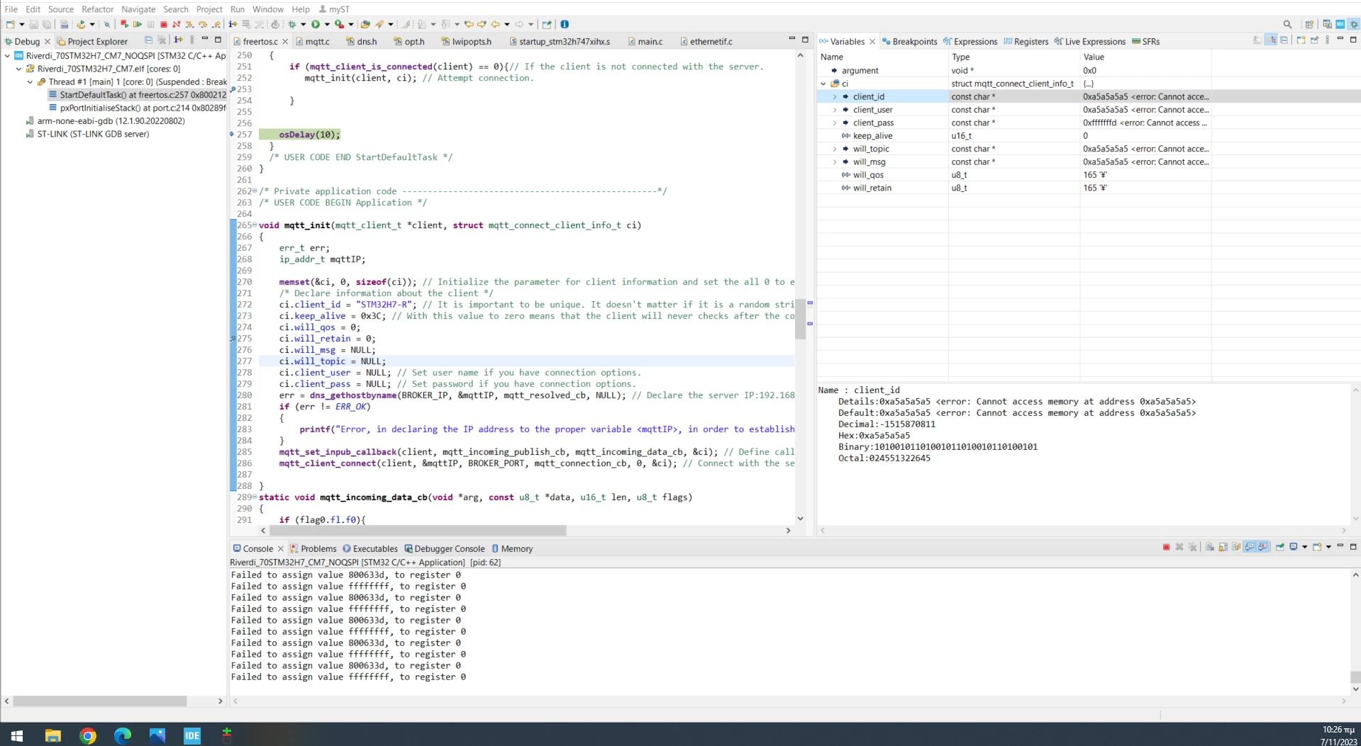

UI in Riverdi doesn't render if keep alive is >0
Hello. I have the Riverdi 7' display with PoE addon. While I am working with a project for this display, where I am trying to implement the MQTT protocol, I am facing an issue that cannot understand. It has to do with the keep alive parameter, if I set it to zero then it acting normal. For instance it is able to read messages and also to print them to the UI. Nonetheless, if the keep alive parameter is greater to zero then the UI cannot render to the screen. The only thing I see is a black screen. I am using the LwIP library.

Just an update: Using debbuger I have found that when I have the keep alive param > 0, then it shows this as a log output msg:
Failed to assign value 800623d, to register 0
Failed to assign value 3000404c, to register 0
Failed to assign value 2407ffb8, to register 0
Failed to assign value 80314e8, to register 0
Failed to assign value 80314e8, to register 0. Do you know what might could be?

I set a small delay before the call of the function mqtt_client_connect and then it renders the UI to the screen correctly, although the mqtt subscription is not showing any more to the screen.
Bob S
Nov 6, 2023 10:23 PM UTC
The fact that your code ended up in the fault handler means something is broken in your code.  Adding that delay is just masking the problem, not (necessarily) fixing it.  Use the CubeIDE fault handler to look at the fault registers and see what instruction caused the fault.
As for those "Failed to assign" messages, who or what code is printing those?  What "log output" message?
Senior
Nov 7, 2023 8:36 AM UTC
I used the debugger mode in the IDE and found that output into the code when I am using a value greater to zero in keep.alive. I should mention that I use demical and hex value and the same issue happens (I didn't know if this dummy approach would work so I give it a try). As far as you can see, also I have not used any king of log outputs and that msg, which is about "failed to write into reg 0" it printing it by itself (or with a reason that I cannot explain). I am posting an image from the debugger. Despite I have use a client id a keep alive value and other stuff like that, debugger says that  Cannot access memory at address 0xa5a5a5a5>. As you can see I have the code where I am manipulating the ci param and also
the mqtt connection. I cannot explain this behavior and I don't also have the experience to dig into it and trace the problem further
that's why I ask for help and at this point I should thank you all of you for your reply at my topic!

Nov 7, 2023 12:33 PM UTC
Update: I have found the issue that causes the hard fault.  It was wrong the address  in linkerscript, which I had set for Rxpool buffers. Now it is rendering properly and also MQTT, is connecting to the broker.
