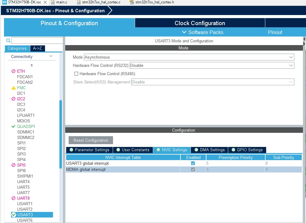

Im working on touchgfx with STM32H750XBH-DK eval board and gyro sensor. So I try to display the data using UART which I want to display using serial monitor(tera term) but its doesn't work and nothing display in my monitor.
Basically i have try using UART using the board only and everything is ok but when I want to use the touchgfx, the UART doesn't work. Anyone know why and how to solve the problem?
UART STM32H750XBH-DK pin - USART3(PB11 & PB10)

How do you implement USART3 transmit code, how many char do you want to transmit and what baudrate ?
Inside the TouchGFX GUI task with Model::tick overload or in a specific new OS task ?
Have you read the recommendations below ?
https://support.touchgfx.com/4.20/docs/development/ui-development/touchgfx-engine-features/backend-communication
