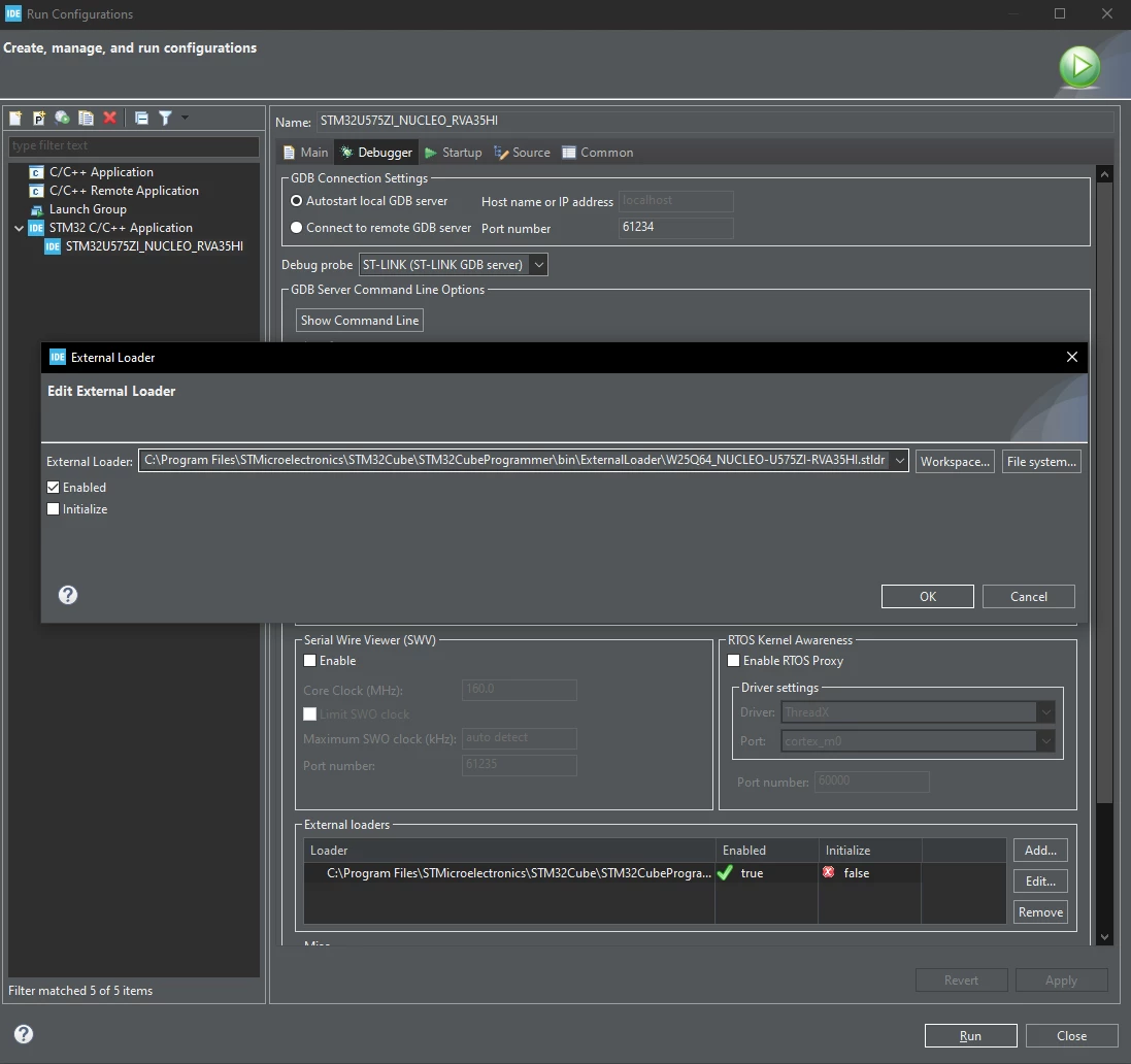

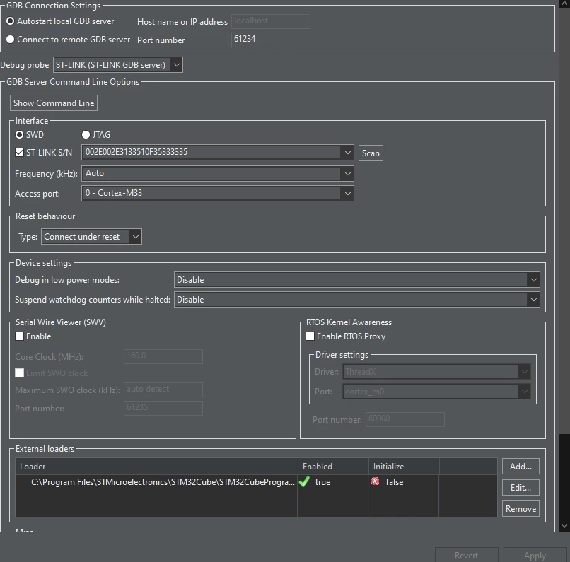

I have also tried to run the project via STM32CubeIDE
Here are my run configurations for the same:

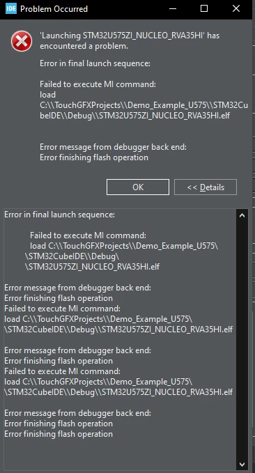

This is the error I am getting for STM32CubeIDE:
STMicroelectronics ST-LINK GDB server. Version 7.9.0
Copyright (c) 2024, STMicroelectronics. All rights reserved.
Starting server with the following options:
 Persistent Mode : Disabled
 Logging Level : 1
 Listen Port Number : 61234
 Status Refresh Delay : 15s
 Verbose Mode : Disabled
 SWD Debug : Enabled
 InitWhile : Enabled
Waiting for debugger connection...
Debugger connected
Debugger connected
 STM32CubeProgrammer v2.18.0
Log output file: C:\Users\CVISWA~1\AppData\Local\Temp\STM32CubeProgrammer_a11664.log
ST-LINK SN : 002E002E3133510F35333335
ST-LINK FW : V3J15M7
Board : NUCLEO-U575ZI-Q
Voltage : 3.28V
SWD freq : 8000 KHz
Connect mode: Under Reset
Reset mode : Hardware reset
Device ID : 0x482
Revision ID : Rev X
Device name : STM32U575/STM32U585
Flash size : 2 MBytes
Device type : MCU
Device CPU : Cortex-M33
BL Version : 0x92
Debug in Low Power mode enabled
 Choose flashing speed for Cortex M33 series.(default speed=Reliable)
Opening and parsing file: ST-LINK_GDB_server_a11664.srec
Memory Programming ...
 File : ST-LINK_GDB_server_a11664.srec
 Address : 0x08000000
Erasing internal memory sectors [0 34]
Erasing memory corresponding to segment 1:
Erasing external memory sectors [0 1185]
Error: failed to erase memory
Encountered Error when opening C:\ST\STM32CubeIDE_1.17.0\STM32CubeIDE\plugins\com.st.stm32cube.ide.mcu.externaltools.cubeprogrammer.win32_2.2.0.202409170845\tools\bin\STM32_Programmer_CLI.exe
Error in STM32CubeProgrammer
Shutting down...
Exit.
I have also tried directly programming using STM32CubeProgrammer (made sure to select the same loader as before), however I get the same error as before which is:

Nathan_Xi
Dec 3, 2024 12:12 AM UTC
Greetings.
Sorry I don't have a sample of that screen, but it would be possible that you got an older version of the screen module. Could you tell me the detailed version?
CharanVisAuthor
Dec 3, 2024 12:16 AM UTC
The detailed version is as follows:
RVA35HI-NUCLEO144A V1.0A
This display is from Riverdi
Nathan_Xi
Dec 3, 2024 1:46 AM UTC
Well, it seems that it was the wrong version that caused the problem.
The template on the TouchGFX designer is for the REV1.1.
It is possible that a change of the external flash had been made in the latest hw design.
I'm sorry to hear that.
