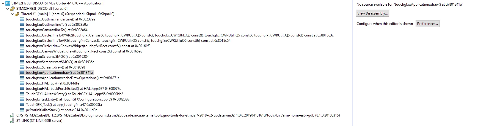

No a fault handler, but if I set in pause the program I'm always blocked into the touchgfx::Outline::renderLine every time. If I play the program and pause again I'm in the same function with a different program counter but closer to the previous one.
I really don't know where I could have done a mistake.
I attach an image of the STM32CubeIde call stack crashTouchGfx
I hope you can help me to figure out the problem, or where I could have made a mistake.

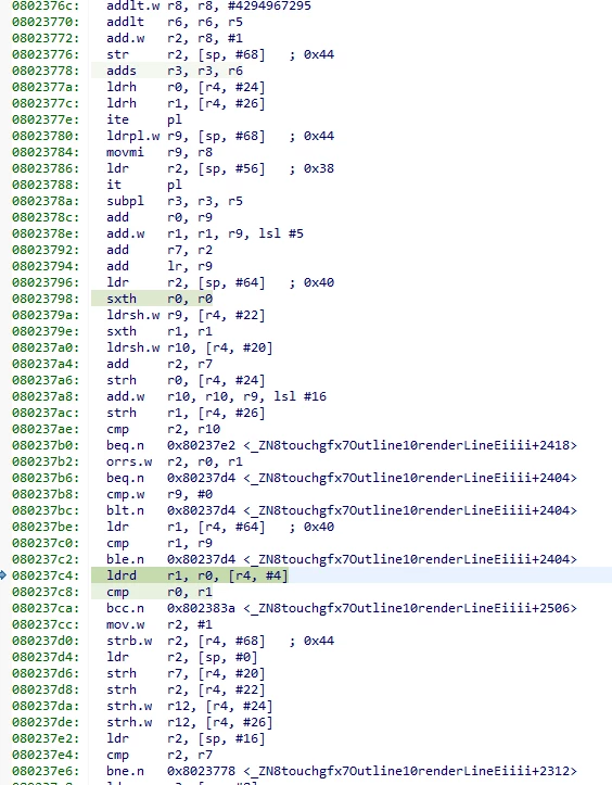

I could only place this disassembly. The code continue to run over this lines of code.

I have also read into your documentation that if the canvas buffer is too short, some drawing operation will not accomplish, drawing partially some widget. But here it seems a never ending loop. So I have no proof to say that I'm right, but I cannot explain the problem better in this situation.
