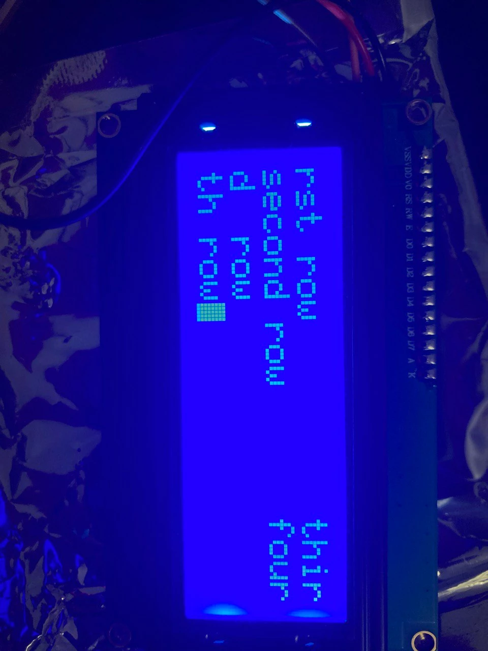

trying to use a lcd20x4 with NUCLEO-F401RE throgh i2c comminication using a PCF8574T.
I'm trying to write on a LCD named 2004A. The problem is that the row i write are mixed up.
I attached a photo of the result and the two main file of the project.
Thanks for yout help.

Hello @EnricoR​,
Welcome to the Community :beaming_face_with_smiling_eyes:
You find some modification in the files bellow with comments.
 Foued

Hello! Thanks for yout help.
I tried to run the code with you modification but the result is even wroste. This time it display only the first row, always with error.
