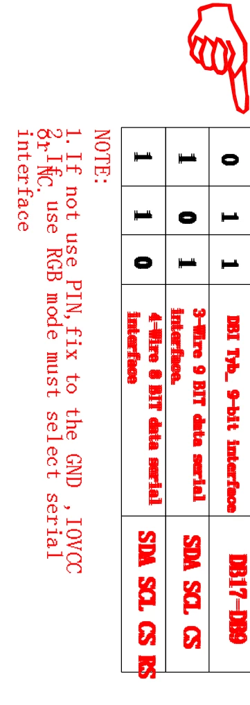

Now in the datasheet from the ST7789V driver which is on board of the MDT0130CIS-MULTI display it says the following.
Can I conclude from this that I cant drive this display with LTDC and Touch GFX?

    Hi Will, in pdf you can see
    then as writed here for RGB (LTDC) you require set last two lines i mean better 101, and connection on connector HSYNC VSYNC DE ... for LTDC require right connection to STM. Display can be set as RGB 666 or 565 based on your choice package STM ...

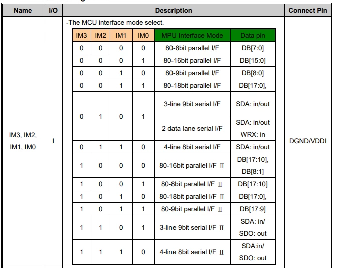

    Interesting but shouldn't it be 010?
    M2: 0
    M1: 1
    M0: 0
    18-bit interface
    DB17-DB0
    I took RGB565, its a STM32f429.
    Maybe its a synchronization error then because I tried 010 and 101 but it stays black.

    No 010 is 8080 paralel interface for memory access (FMC), no video LTDC RGB.
