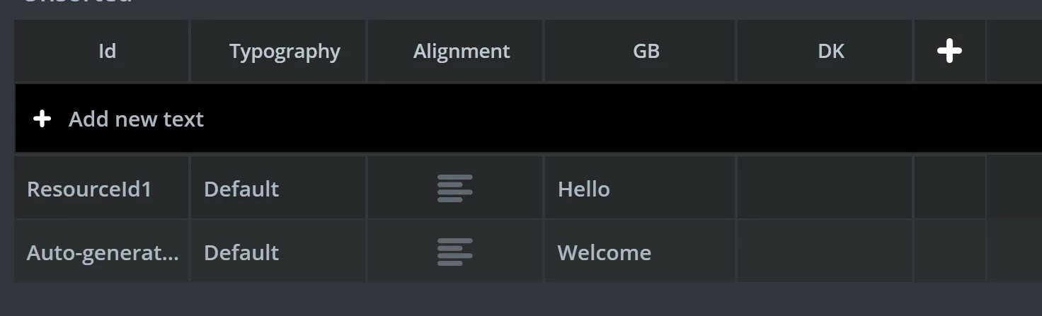

You can edit the generated .xml file but replacing it completely might causes some issue. What I suggest is to add the language from the designer and keep the text empty, then add the values you need into the .xml file. It would be like this:
 <TextGroup Id="Unsorted">
 <Text Id="ResourceId1" Alignment="Left" TypographyId="Default">
 <Translation Language="GB">Hello</Translation>
 <Translation Language="DK">Hej</Translation>
 </Text>
 <Text Id="__SingleUse_CJ9S" Alignment="Left" TypographyId="Default">
 <Translation Language="GB">Welcome</Translation>
 <Translation Language="DK">Velkommen</Translation>
 </Text>
 </TextGroup>

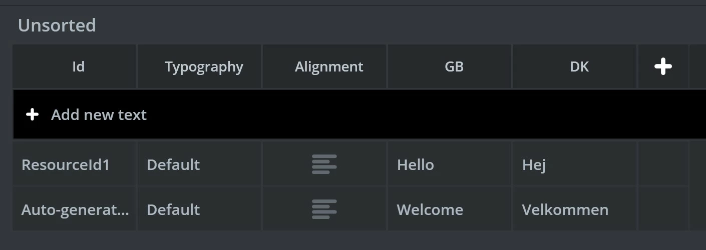

which results in:
But for your second question, unfortunately, there are no ways currently to find the usage of each text. However, we will surely consider this problem for future.
