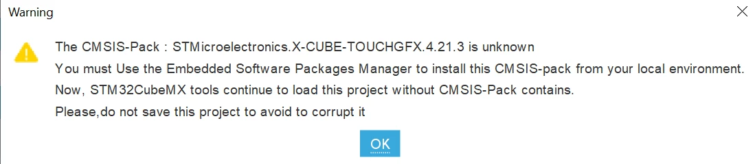

I installed the latest TouchGFX release 4.21.3 for my new project. Separately I now opened the project in the latest Cube Version 6.8.0. and I get a message that tells me that the CMSIS-Pack for my TouchGFX project is unknown.
Where can I get the new corresponding release?

I thought it might be fixed if I regenerate the code using STM32CubeMX, but then I get a warning that the CMSIS pack is missing:
Can anybody assist please???

You need to install the X-CUBE-TouchGFX manually into CubeMX, please follow the steps described by @Romain DIELEMAN​  in the comment of this post.
Let me know if that fixes your issues.

Hello Yoann,
thank you for this info! It helped and fixed both issues! Thanks a lot - now I can go ahead...
