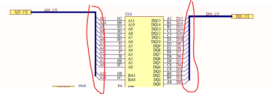

When external RAM is activated, the touch part doesn't work. To be sure, I activated external RAM on the development board(STM32H7B3I-DK). I tryed development board(STM32H7B3I-DK) it work with external RAM. But it doesn't work on custom board. Why is the touch part not working?
Why does adding RAM affect the touch part?
I checked hardware, clock is normal, pins goes true place.
I see the RAM has been added.

Touchscreens must be extremely sensitive in order to detect finger touches well. However, this also results in extreme sensitivity to interference radiation, e.g. from the control lines of the DRAM.
Please check the layout very carefully, i.e. matching the tracks (exactly the same length), their impedance, etc.
Regards
/Peter
Freedom_Neo
Senior
February 15, 2022
You mean these as control lines?
Peter BENSCH
February 15, 2022
Well, I mean all lines carrying high frequencies: address/data bus, CLK, etc.

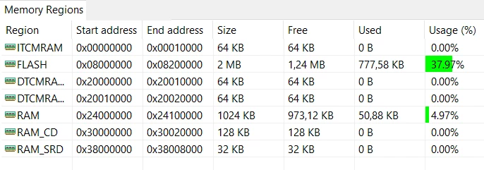

When Extarnal RAM is canceled, the touch part works but detects late. What could be the reason for this? After all, I disable external RAM and disable it from CubeIDE settings. I am removing the codes related to external RAM in the code. But the touch part works with a little delay.
I'm trying the code before enabling the external RAM to see this effect. In that code, the touch part works fine.
