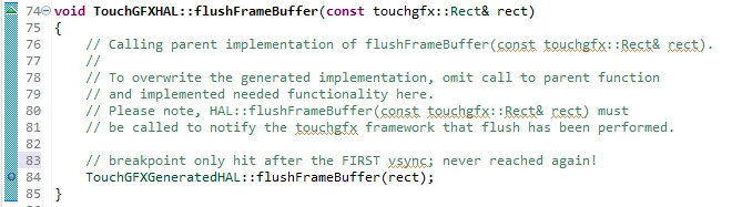

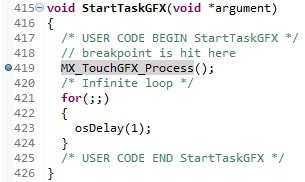

Considering existing posts and instructions in the documentation, I can't manage the framework to call flushFrameBuffer() regularly after a vsync.

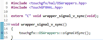

The main issue is that TouchGFXHAL::flushFrameBuffer() is only called once after the first OSWrappers::signalVSync() (and never again). I've deleted all display drivers and checked with a breakpoint that is only hit once in TouchGFXHAL::flushFrameBuffer(). OSWrappers::signalVSync() is triggered by a button and an external interrupt callback. All code that I added is attached. The board is a F303RE Nucleo. Settings of TouchGFX see below.
Many thanks for considering my request.
Sync wrapper. Breakpoint hit on each button press.
Callback on button press. Calls the wrapper function from above.0693W000008GH03QAG.png
Breakpoint gets hit.0693W000008GH6PQAW.pngBreakpoint only hit on first button press!0693W000008GH6jQAG.pngTouchGFX settings.0693W000008GH6oQAG.png
Best answer by N. SANTINI
Indeed, the flushFrameBuffer function is called by the TouchGFX library only when something has changed in the frame buffer.
Best regards,
Nicolas
check if gpio exti for you work once or more
MKiss.1
MKiss.1Author
February 16, 2021
The LED toggling works as expected. Also, a breakpoint in OSWrappers::signalVSync() is hit on each button press.

N. SANTINI
N. SANTINIBest answer
February 26, 2021
Best regards,
Nicolas
