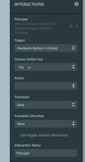

[TouchGFXDesigner] Hardware button BUG
If I setup hardware button is clocked on screen1 it works.
If I switch to screen2 in designer and come back to screen1, I lose some information
See attached image

I'm just told it's already been fixed in the upcoming 4.13.0 by the designer team :) The action was still being generated, but the action was hidden for some reason.
Thanks for the report!

Just in TouchGFX designer.
If I chose "change screen" or "hide widget" in action field, touchGFX_DESIGNER should keep this information.
But in my project, it do not.
You see in my screenshot the action field is empty.
Normaly, I selected "change screen"
And you have to know the code is well generated by touchGFX designer.

You're right. I have the same issue here.
The code generates fine but the drop-down is not re-populated with the right info.
@Martin KJELDSEN​ - You might want to forward this to the designer people :)

Thanks for the heads up, it's already been fixed :) This caused some serious issues when upgrading projects with "change screen" interactions since no go to methods were being generated!
/Martin

By "some information" do you mean the action?
What was the action? I can't replicate it here on 4.12.3.
