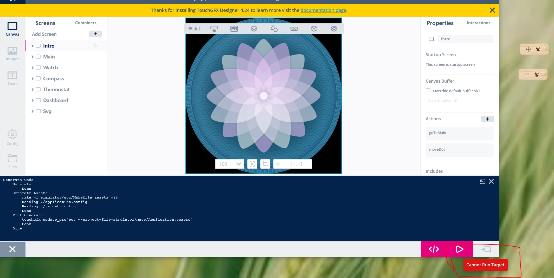

TouchGFXDesigner cannot run target
1. Developing tools directories as this:
D:\ProgramData\STMicroelectronics\STM32Cube\STM32CubeMX
D:\ProgramData\STMicroelectronics\STM32Cube\STM32CubeProgrammer
D:\ProgramData\STMicroelectronics\TouchGFX\4.24.2\
2. ST link drivers are installed well.(because code can be compiled and downloaded via usb ST-link)
3. Hardware is STM32U5A9J-DK.

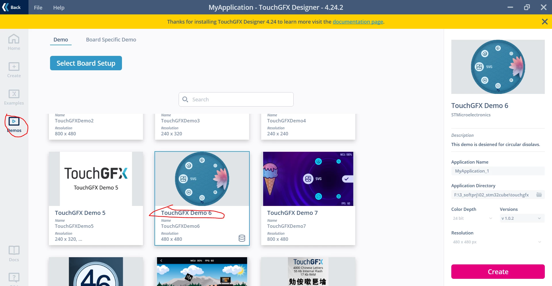

4. TouchGFX Designer demo is TouchGFX Demo6. Run simulator is OK.
My question is:
   I want to run this demo on STM32U5A9J-DK, but the run button can not work and display 'Cannot Run Target'.
   which procedure is wrong? Or is there any guidance to solve this problem?

    Did you select first the board STM32U5A9J-DK in the Board setup before creating the demo?

    rhine1012Author
    Feb 6, 2025 4:14 PM UTC
    It works,thank you!
