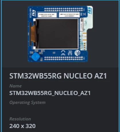

hello everyone i'm a beginner here,i have successfully using my DIY board to that the SPI LCD work without TouchGFX the color and reaction was great.
MCU:stm32wb5mmg
LCD driver:st7789
Display:240x240pixels,RGB565
now i want to use TouchGFX in this project, i try the stm32wb55RG NUCLEO AZ1 demo
0693W00000YAEq2QAH.pngproject in TouchGFX with stm demo board and it work perfectly,i notice the demo board
have the TE pin and external FLASH memory(MX25L6433F)that my DIY board don't have.
Is there possible to use touchgfx in my DIY board(without TE pin and external FLASH memory)?
​Tony.
MM..1
MM..1Best answer
Feb 8, 2023 11:44 AM UTC
If you dont plan super smooth quick animation TE isnt required for SPI
and external flash is required if your graphics resources oversize internal flash.
Good optimized gui no problem.

thanks,i made it and it seems not bad.
