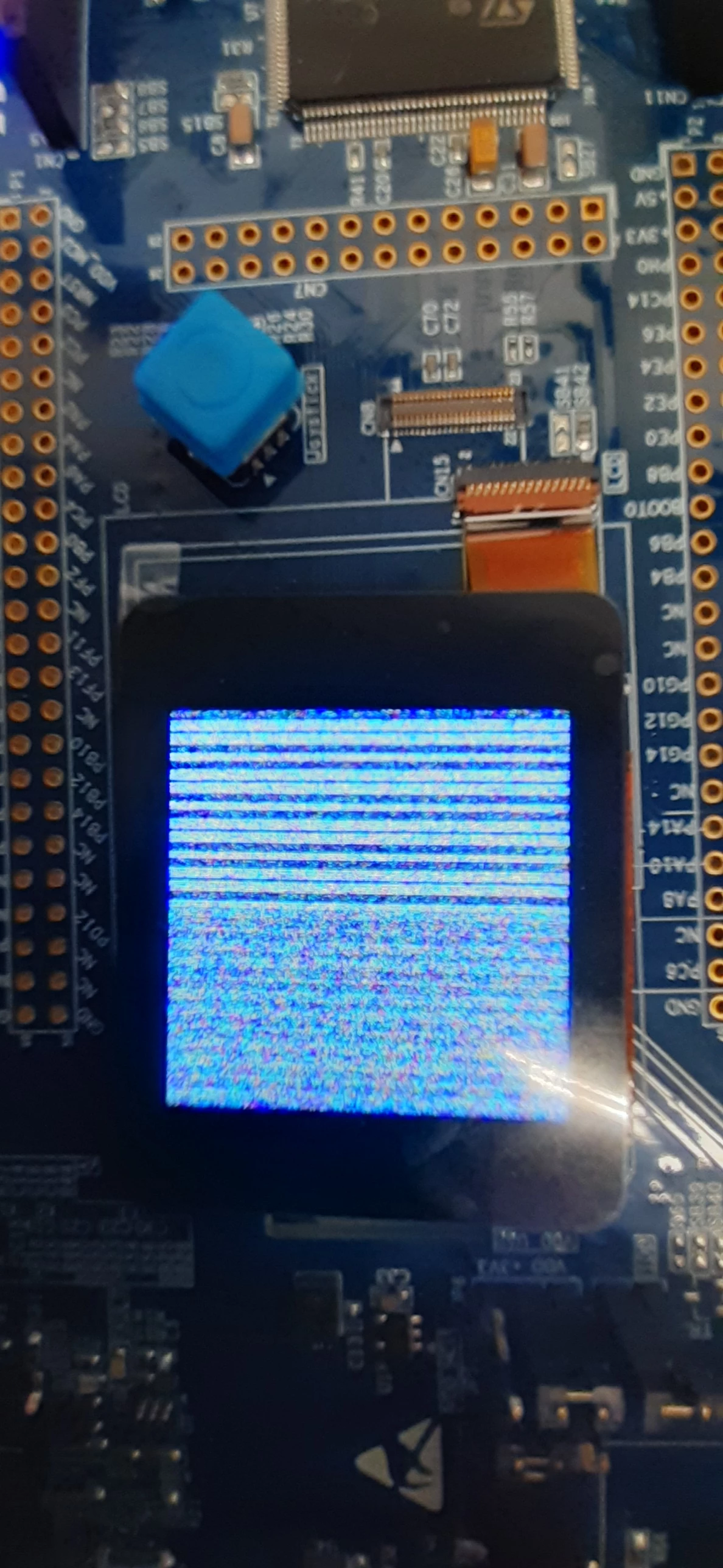

Good morning,
I bought an stm32f412g-disco board but it's impossible to program the screen with a TOUCHGFX application.
I'm using TOUCHGFX Designer 4.23 and stm32cubef4-v1-28
I created a project directly from TOUCHGFX Designer for the F412G-disco board.
But my screen remains blurred (see photo)
Is there a modification to be made in the configuration (.ioc)
THANKS

    Hello @PhilZalkin ,
    Yes, I can confirm the problem. Sorry for the inconvenience. We will fix the board setup as soon as possible

    Any update on this one?
    I got stuck with the same effect. Non of the examples are working form me.
    TouchGfx newly created project do not displays properly.
    MM..1
    February 24, 2024
    Check if this work for your board STM32CubeF4/Projects/STM32F412G-Discovery/Examples/BSP at master · STMicroelectronics/STM32CubeF4 · GitHub
    and after this work try add and customize TouchGFX normal way step by step.
    February 24, 2024
    This one compiles and works not every example, but it's something.
    Now, I did learn already that my board is rev D, thus I have different touch controller, ft3x67 instead of ft6x06.
    Given that I've added a flag `USE_STM32412G_DISCOVERY_REVD` this enables touch sensor test that's a progress :grinning_face:.
    When it comes to TouchFX project, I've also notice that it uses ft6x06... after changing the generated code to use ft3x67 I finally get proper contents on a screen. :smiling_face_with_heart_eyes:
