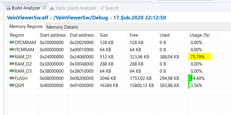

Does the QUADSPI show up on your Build Analzyer?
Also, another time I saw the debug "MI" issue, I was actually out of hard drive space on my computer. I cleared up some space and it worked.
KERDO.1
KERDO.1Author
February 18, 2020
