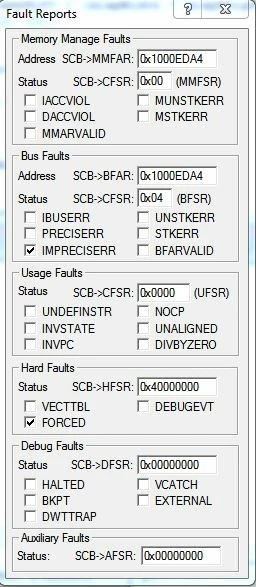

Mahendra Sondagar
Sep 9, 2019 11:04 AM UTC
Hey @Martin KJELDSEN​
I'm back once again with few more test and updates and problems as well =)
As per your suggestions and touch GFX guide for the custom board, I have made few changes in my code
(1) Implemented 60 Hz timer for the signalVSync() (which is working great)
(2) Added and link my custom "generated" and GUI files with the code

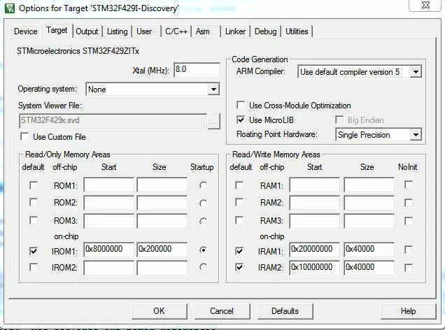

(3) Un-comment "#define SINGLE_FRAME_BUFFER_INTERNAL" for the internal flash and SRAM use (which causes problem!)
with the 3rd change, I'm getting Hard fault
My, target MCU is STM32F429ZI having 2MB flash and 256+4KB SRAM
I'm using keil MDK 5 for as IDE
Here is the memory footprint after compilation code on keil5
Code =  57840  bytes
RO-data= 565412  bytes
RW-data= 2500   bytes
ZI-data=215644
RW-data=2500
For "Option for Target", i have attached in screen shot
Stack_Size EQU   0x5000
Heap_Size   EQU   0x200
FreeRTOS task heap size 2000kb
From the memory footprint, i can say that it should be easily fitted with my MCU, but unfortunately that's not happening!
The functions at where I'm getting hard-fault is shown here
Bitmap::registerBitmapDatabase(BitmapDatabase::getInstance(),
 BitmapDatabase::getInstanceSize(),
 bitmapCache,
 bitmapCacheSize,
 numberOfDynamicBitmaps);
/* Calling from Above BitmapDatabse Function */
namespace BitmapDatabase
const touchgfx::Bitmap::BitmapData* getInstance()
 return bitmap_database; <--------------Cause Hardfault
uint16_t getInstanceSize()
 return (uint16_t)(sizeof(bitmap_database) / sizeof(touchgfx::Bitmap::BitmapData));
@Martin KJELDSEN​ Can you give me any suggestions ?

Martin KJELDSEN
Principal III
Sep 13, 2019 9:33 AM UTC
The Bitmapdatabase is often located in external flash. Do you have external NOR flash? If this address is not accessible i think that call to getBitmapDatabase() will hardfault.

Mahendra Sondagar
Sep 14, 2019 7:12 AM UTC
Thanks Martin for the feedback,
I have external SPI flash (i don't think that is memory mapped)
But i have decided to use with the internal storage and that's why I have Un-comment "SINGLE_FRAME_BUFFER_INTERNAL"
Not only that, from fonts and Bitmap files i have removed "KEEP" and "ExtFlashStorage" macros to occupy internal storage only
