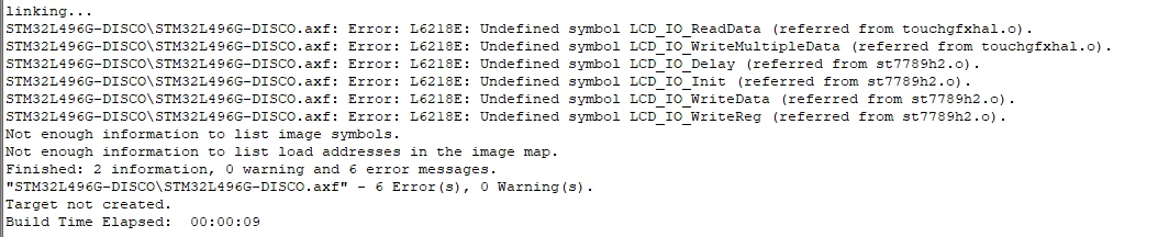

Hello. We have a need to work with a 16-bit 8080 style LCD interface. Would like to have the benefits of the latest TouchGFX tool (4.16.0) and STM32CubeMX to build quickly and debug our GUI screens. After some investigation, found the following kit which appears to be close to our hardware need:
STM32L496G-DISCO
Ran TouchGFX -> created a fresh project using this target kit -> imported the Pool Lights demo -> ran the simulator -> runs fine -> Generated the Code.

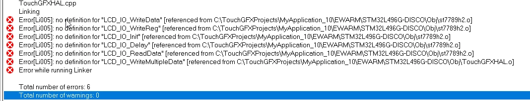

Launched the STM32CubeMX .ioc file from the project folder -> toolchain requested to migrate to the current versions of the wizard code -> allowed for this update -> selected IAR compiler -> went back to TouchGFX to re-generate the code for the IAR target compiler -> returned to STM32CubeMX and built the project -> launched the IAR compiler -> compiled -> facing assorted errors.
Same errors with Keil compiler. Screens are attached.
Can anyone share if we are properly building for this target kit and toolchains?

First you did well, but not enough !
First, in all the application templates that come with a CubeMX project (i.e. version 3.x.x) the default configured IDE is SMT32CubeIDE.
The missing symbols mentioned in your build report correspond to the display's low-level driver, also called "BSP" (Board Specific Package) or "Vendor Code" (see https://support.touchgfx.com/docs/development/board-bring-up/board-introduction) and this is not handled by CubeMX.
In the provided CubeIDE project these files (located in Drivers\BSP\Components\) have been manually added after CubeMX code generation to provide a functional project in the downloaded application template.
So besides changing the IDE in CubeMX you must do the following:
  • open the TouchGFX Designer project and generate the code since this is when the Designer checks the selected IDE (by parsing the CubeMX .ioc file) and thus updates the corresponding project file with the source files corresponding to the GUI.
  • Add to your IAR or Keil project all the BSP files (and corresponding include paths) as CubeMX does not have the information of the display or the memory or any other external component that is actually connected to the MCU, it only knows the configuration of the interfaces needed to interact with it.
The good new is that for this Development Kit all these are provided, you just need to point to them.
To be safe I recommend you to make a copy of the original application template and open the STM32CubeIDE project as a reference when updating your IAR or Keil project.
I hope this will help you progress.

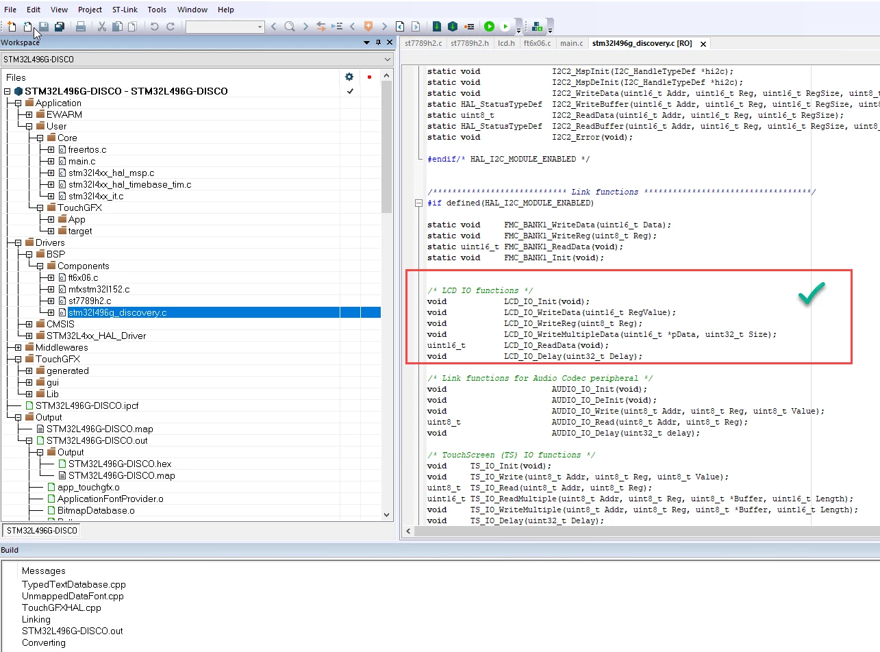

Thank you both for your replies.
Found the BSP support file inside the en.stm32cubel4_v1-15-0 download.
Specifically,
Downloads\en.stm32cubel4_v1-15-0\STM32Cube_FW_L4_V1.15.0\Drivers\BSP\STM32L496G-Discovery\stm32l496g_discovery.c
Added the above to my BSP tree structure inside the IAR project. Compiles now without errors.

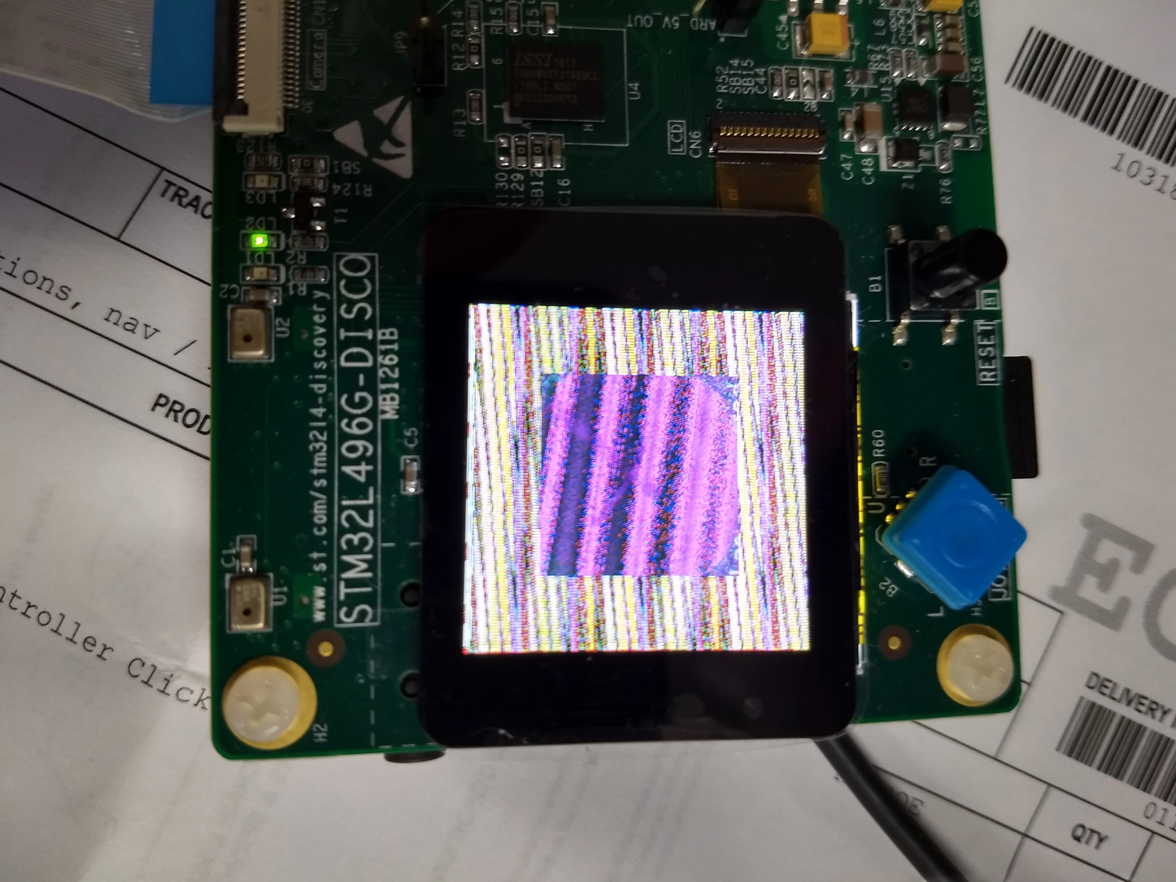

Created an output .hex file -> used the STM32CubeProgrammer to load this .hex file onto the target kit. The results are not matching the imported analog watch gui.

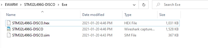

Is the single .hex file generated on the IAR tool the equivalent of the internal & external flash memory regions? The issue may be that the .hex file is not inclusive of all the memory regions that are required for this project.

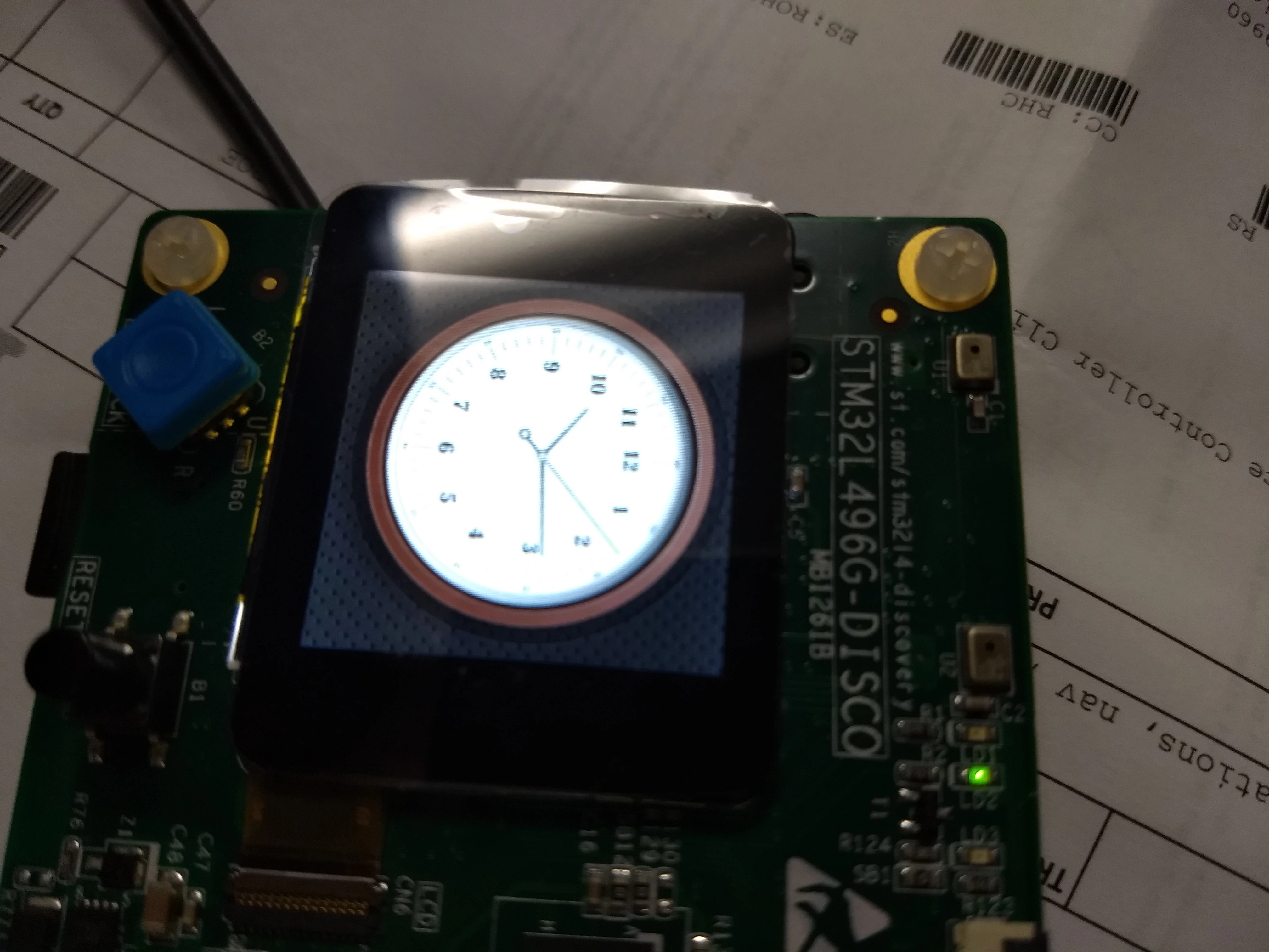

Bad watch after programming of .hex file generated with IAR:
Good watch after Run on Target option was selected inside TouchGFX:

The generated .hex file contains 2 kind of data, a part that will be put in internal FLASH and another part that will be put in external one (see scatter file .icf file).
The data put in external FLASH is notably the input bitmaps such as the demo background and the clock background in your case.
To put data in external flash you need to provide an external loader in CubeProgrammer, in the "EL" section on the left panel search for the L496-Disco external loader and select it.
Then program you board again.
STM32CubeIDE contains its own internal CubeProgrammer and thus automatically program the external FLASH as well as the TouchGFX Designer that uses makefile-based build/flash toolchain, see "gcc\Makefile". In fact TouchGFX Designer builds 2 binary files intflash.bin and extflash.bin and program the external flash using your installed CubeProgrammer in command-line and uses the external loader for L496-Disco, see following line in the Makefile:
stm32cubeLoader := STMicroelectronics\\STM32Cube\\STM32CubeProgrammer\\bin\\ExternalLoader\\MX25R6435F_STM32L496G-DISCO.stldr
So again, just select the proper external loader (MX25R6435F_STM32L496G-DISCO) in CubeProgrammer and flash again, it will program both internal and external FLASH and you will then see the proper images instead of noise (uninitialized memory).

0693W000007CDscQAG.pngThank you again Nicolas. Your level of support is priceless. The tools have come a long ways but the packaging of the documentation is still a bit written in a style that only twins will understand. Hence the never ending list of questions. Believe we are now close to having a working procedure to quickly develop GUI menus for our embedded design.

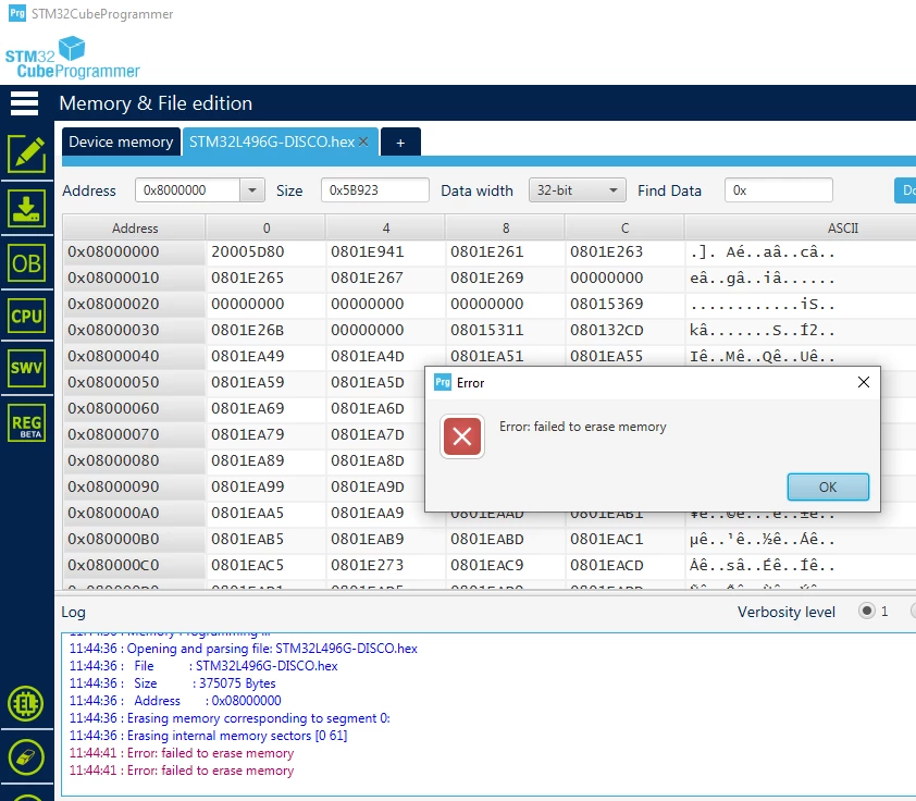

2) The STM32CubeProgrammer is acting a bit funky. Always appears to complain about an erase failure 2 times. Pressed Download again and the kit was reflashed ok.

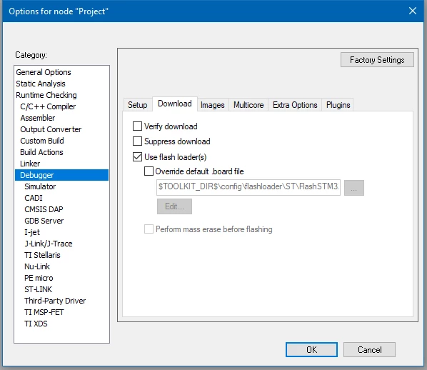

This can happen, sometimes the board needs a power reset to clean the RAM, but normally IAR also supports the ST devkits, thanks to a partnership, so you should be able to flash directly from IAR, check the following parameters (attached screenshot).
Finally you can of course go back to the designer, update your GUI and then rebuild back on IAR (it will signal that project has been updated), you can do the same from CubeMX side, e.g. add new peripherals and generate the code, both Designer and CubeMX are made to work this way that is why the CubeMX stores the chosen IDE to share the info with the Designer as I explained above, so you can go back and forth from both Designer and CubeMX and then build and debug from IAR.
