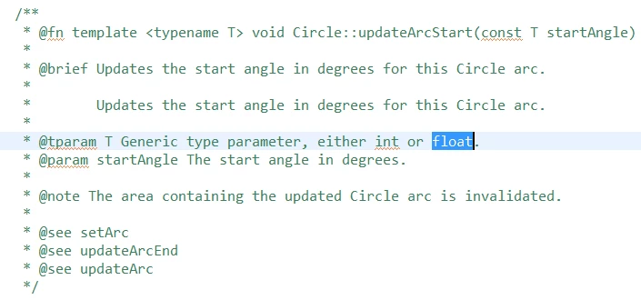

Would it be possible to add floating point parameters to the Circle widget in the Designer?
As of the latest version (4.14.0), only integers appear to be valid (start and end angle is in 1 degree increments, for example). It is possible to use floating points for the functions updateArcStart() and updateArcEnd() in the code:
Would it be possible to add this to the Designer as well?
Martin KJELDSEN
Principal III
August 31, 2020
Anything is possible, Scott! :) I'll do some detective work as to why there's no support for floats in the designer.

October 26, 2020
@Martin KJELDSEN​
I see that the Circle Widget in the Designer does not support floats in the latest version of TouchGFX (4.15.0).
