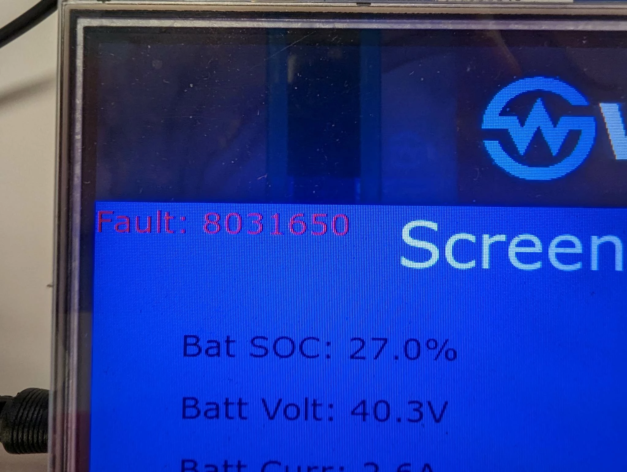

I am using the TouchGFX application to display data gathered from CANbus communication, which I have verified is working. One feature I wanted to have is the following logic for fault error codes:
If a fault is present, display the error code in hexadecimal (with a user manual to outline the meaning of said error codes) in red.
If no fault is present, then I want NO text to be present. I do not want to show "0x00000000". I just want no text to be there at all.
I've attached a snippet of my code that writes the value into the wildcard currently. This solution does not work.
void Screen1View::UpdateFaults(uint64_t value){
	if(value != 0x00000000){
		Unicode::snprintf(textFaultSigBuffer, TEXTFAULTSIG_SIZE, "%x", value);
	else{
		Unicode::snprintf(textFaultSigBuffer,TEXTFAULTSIG_SIZE, "%x","" );
	 // Invalidate text area, which will result in it being redrawn in next tick.
	textFaultSig.invalidate();
Instead of displaying a blank space, it shows 8031650 (like in the picture).
Does anyone know how to make it just display no text at all?
 		textFaultSig.setVisible(1); // Shows to object
 	else{
// 		Unicode::snprintf(textFaultSigBuffer,TEXTFAULTSIG_SIZE, "%x","" );
 		textFaultSig.setVisible(0); // Hides to object
Just set it visible or not, if I understand right what you need ?

Hello JTP,
Yes, this is exactly what I needed! I just tried it and it worked exactly as I wanted.
Thank you!

Your error is
right is
Unicode::snprintf(textFaultSigBuffer,TEXTFAULTSIG_SIZE, "" );
or
Unicode::snprintf(textFaultSigBuffer,TEXTFAULTSIG_SIZE, "%s","" );
KMew
KMewAuthor
Senior III
Mar 1, 2023 6:48 PM UTC
Ooohh interesting.
So if I did it your way, whatever was in the wildcard spot would go away and the non-wildcard part would stay, correct? For example:
"Fault: " - Non wildcard, so it would stay
But the wildcard part (the actual error code in hex) would be blank.
JTP's way gets rid of all wildcard and non-wildcard text, while yours gets rid of just the wildcard portion. This is most helpful! Now I can do both options.
