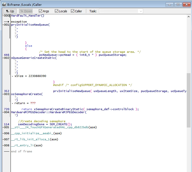

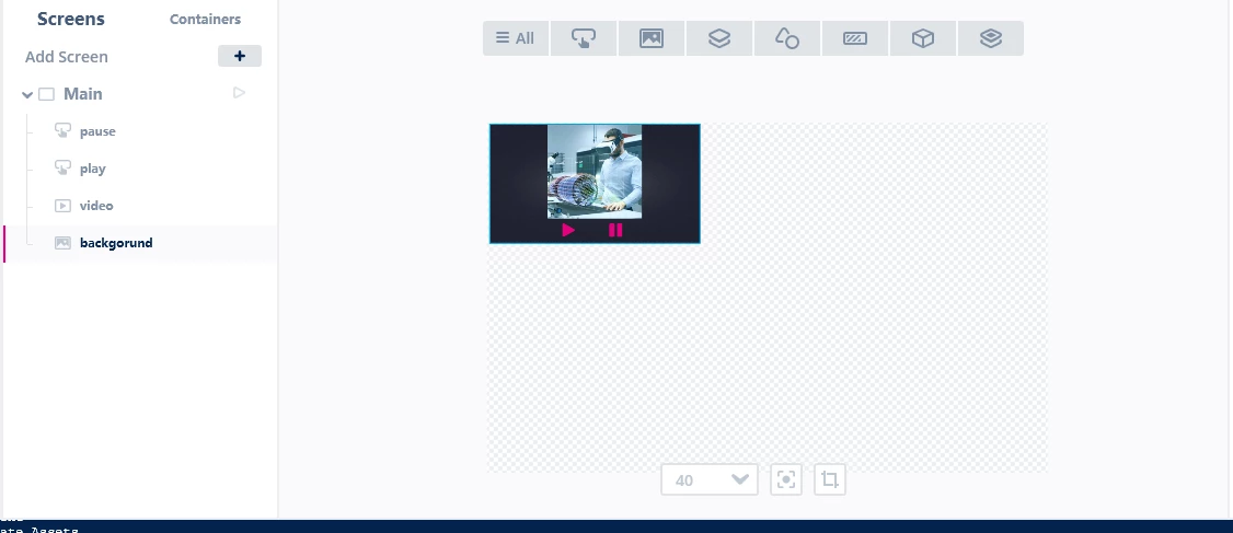

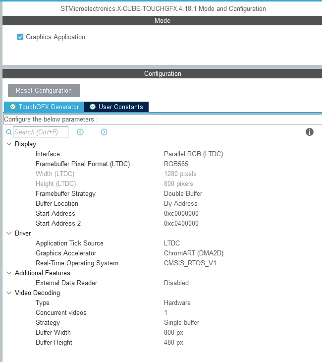

I have a STM32F767 board, and a demo with 10.1 inch display which is working fine without video.
And I tried to add only one, like below, and when I download the code into the MCU, it will run into hardware fault.
After some debug, I found in:
  1. it will not able to run to main of the c code;

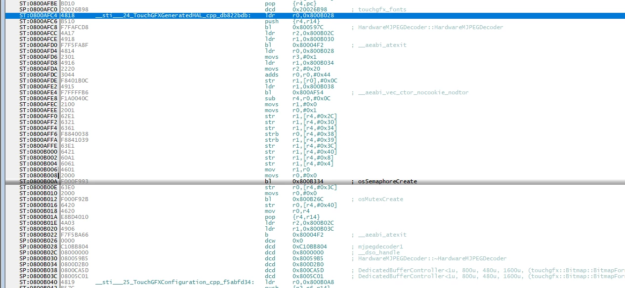

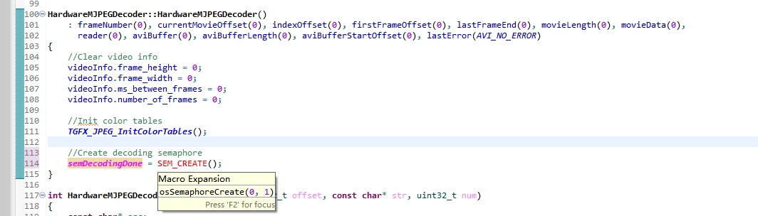

  2. in __main, it will call some cpp initialization code, and will call some freertos api, this cause some problem, you can ref to below picture, I'm not very familiar with C++
0693W00000KcnFGQAZ.png The call stack
 0693W00000Kcr1XQAR.png0693W00000Kcr5yQAB.pngThis I really don't understood, why this generated code will call the osSemaphoreCreate at this time, because the freertos is not initialized yet?
0693W00000KcrESQAZ.pngmy configuration in mx
version information:
0693W00000KcnIaQAJ.png0693W00000KcnIyQAJ.pngAppreciate for your comments, thanks.

Hello Guopeng,
Adding video requires a bit of configuration which is described in this documentation (+ this one)
There's a paragraph about STM32F7 series here, as far as I see there is important steps about configuring RGB_FORMAT and DMA Settings. If you haven't already, I suggest you to see this docs and if you have any question about it or if you still have your issue, don't hesitate to post it on the forum.

Hello Guopeng,
Have you created a dedicated task for the video decoding ?
The F769-DK TBS available in TouchGFX Designer supports the video widget out-of-the-box.
Please check and make sure that you have the same configuration on your side.
