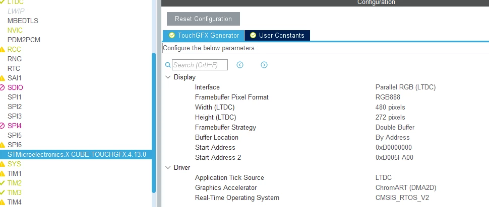

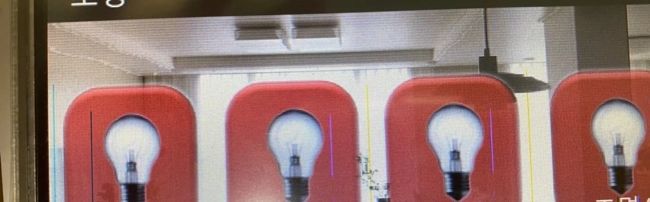

I am working on a project to control LCD with a custom board using stm32f429IG.
I succeeded in displaying the screen, but vertical line noise occurs in each element.
It was confirmed that there was no abnormality in the arrangement data of each image using 'lcd image converter'.
Can touchgfx be affected when displaying the screen and produce this kind of noise?
Please let me know if there is a way to fix the noise.
  • using cubemx, touchgfx
  • 480x272 rgb888
  • using SDRAM

How did you create the project?
/Martin
ssooki
ssookiAuthor
August 11, 2020
I made it in the same way as the link below.
https://support.touchgfx.com/docs/development/touchgfx-hal-development/touchgfx-generator
It is different from the previously uploaded screen composition, but the symptom is the same project file attached.

Can you dump the framebuffer to see if this issue is in memory? (probably is).
ssooki
ssookiAuthor
August 12, 2020
It is being tested with the screen shown in the attached file(test_screen.png).
Like the code below, I directly read the temporary address value for one line on the screen.
for(i=0; i<((3*480)/4); i++) {
printf("\r\n%08X", *(uint32_t *)(0xD0000000+(i*4)));
The screen also shows a vertical black line and yelllow line on the left unintended, and the frame buffer also shows unintended data.
(Attach data(framebuffer_data.txt) and screen(test_screen_result.jpg) information.)
This symptom does not occur without image control in touchgfx.
Is touchgfx doing the wrong conversion?​

Incidentally, The array data of cpp code converted from png file is normal.

To explain in more detail...
  1. create cubemx project
  2. add touchgfx software
  3. ​generate code in cubemx
  4. execute TOUCHGFX/ApplicationTemplate.touchgfx.part
  5. click generate code button in touchgfx

I found a solution.
By changing all the settings to even numbers(Numerical values for all settings such as location, icon, png size, etc.),
we were able to achieve a noise-free screen.
