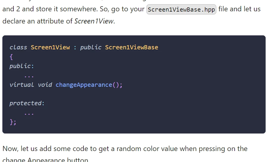

How do I update screen using a wild card. ST docs suggest starting with this:
0693W00000Y9PjZQAV.pngThat file is write protected and does not appear to help. I guess using wild cards is easy.. but how?

MM..1Best answer
Jan 29, 2023 7:30 PM UTC
Simply add to screen textarea with wildcard fill required parts and generate code
in base file you will see syntax definition and in your code use same with your invention
 Unicode::snprintf(informationTextAreaBuffer1, INFORMATIONTEXTAREABUFFER1_SIZE, "%d", randomLineSpacing);
 informationTextArea.invalidate();
