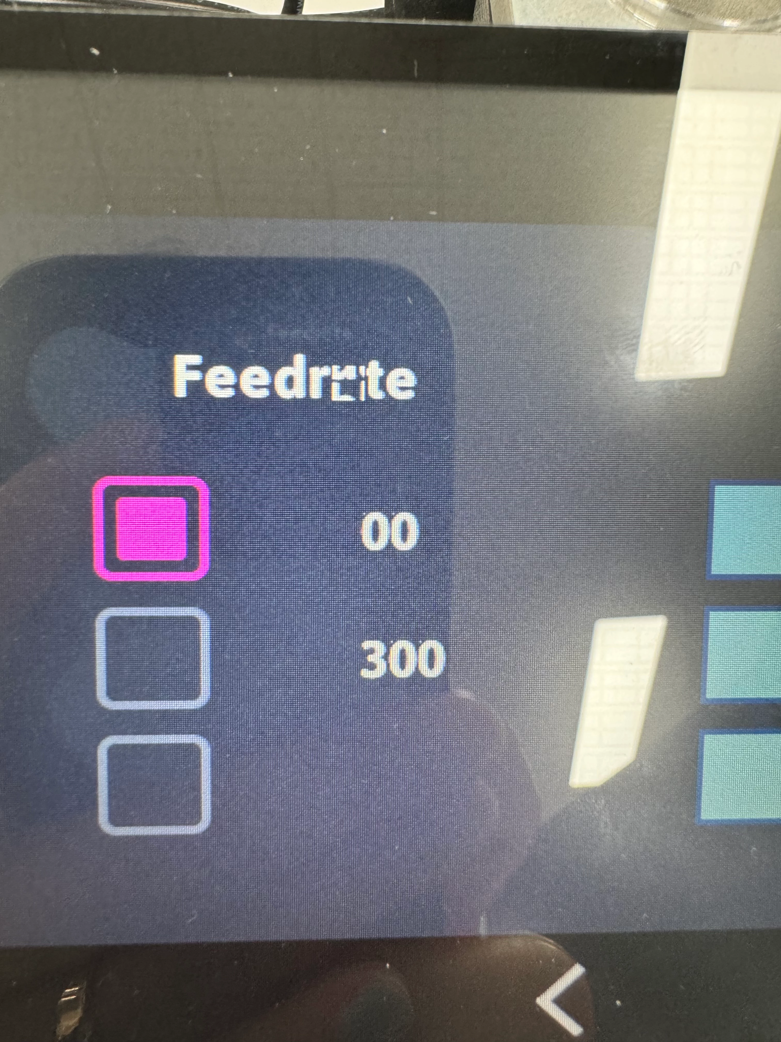

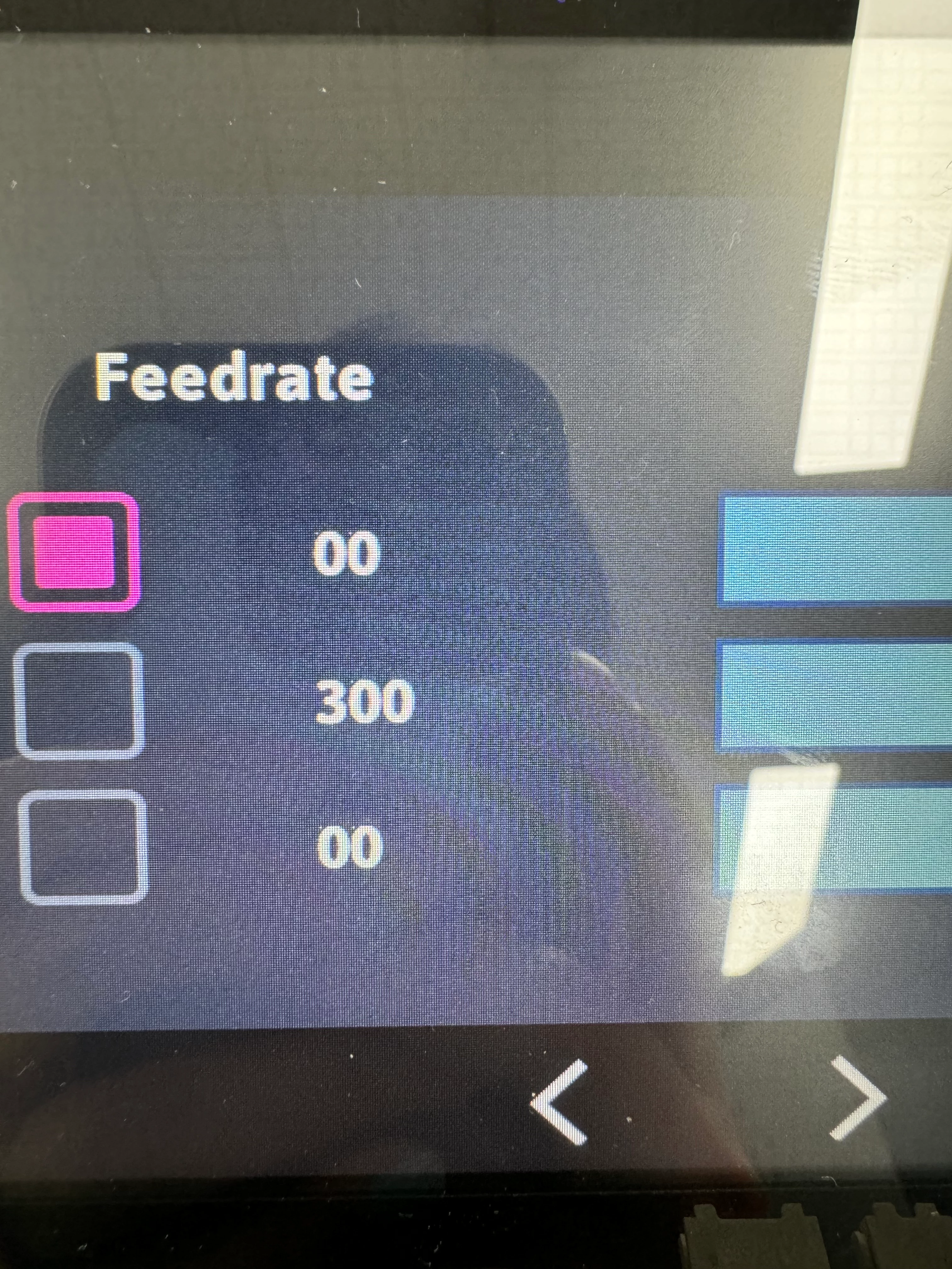

touchgfx textarea is wrong
디스플레이를 터치하면 글자가 깨지거나 이상한 글자가 표시됩니다.
그리고 screen1에 여러 글자를 입력했는데 놔다 켜면 글자가 이상하게 나옵니다. 도움을 주세요.
이 사진은 touchgfx로 디자인된 오리지널 사진입니다.
보드에 이것을 업로드하면 위에처럼 이미지가 사라지거나 이상한 텍스트가 포함되는 경우가 있습니다.
11 replies

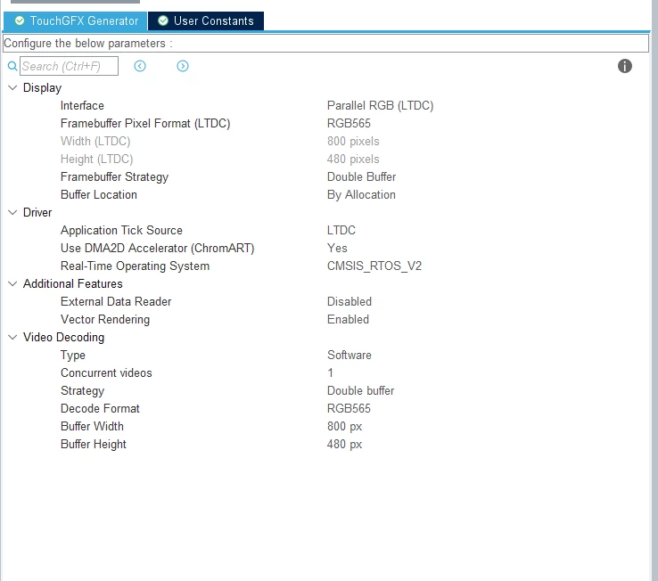

Jul 5, 2024 8:08 AM UTC
Hello @jschoi ,
Could you please share more information on the MCU you are using, the framebuffer strategy, and the place where you store your text and font (internal flash or external flash)?
Are you using the same Typographies for both the numbers and "Feedrate"?
Could you please set the Fallback Characters to "?" to ensure the issue is not from the characters being unrecognized?
looking forward to hearing from you

jschoiAuthor
Jul 5, 2024 9:14 AM UTC
hello,
Thank you for your reply
stm mcu: stm32f746
Text and fonts are stored in external flash memory.
Numbers and feedrate do not use the same Typographies.
I captured the settings in the photo above. Please take a look.
And I entered "?", but "?" does not appear on the display. The same symptoms as the screen captured above still appear.
