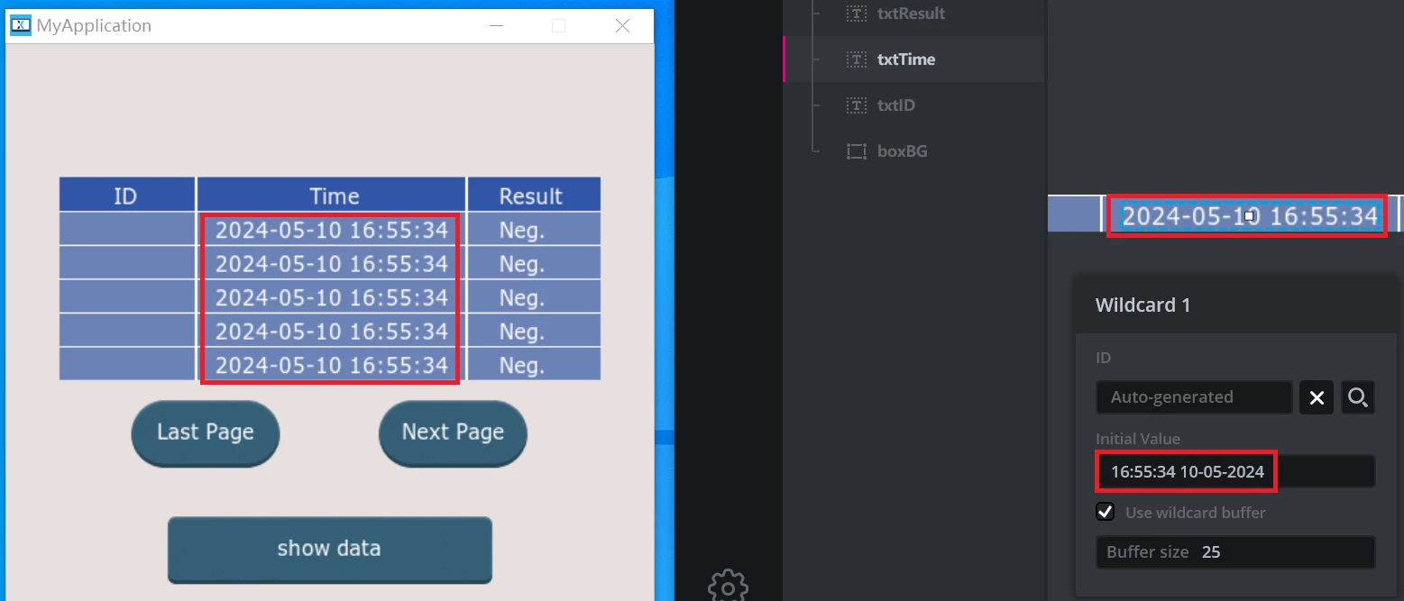

Hi all,
When I config the textArea initial value, the character order I config is different with the display order.
After some test, I find this is because of the character "-".
I already meet this multi-times, is this a bug?
Thanks
Junde

GaetanGodart
May 13, 2024 3:25 PM UTC
Hello @Junde ,
I was not able to reproduce your issue.
I have added a date format as initial value of a wildcard in a textArea just like you :
When launching the simulator, I see the sane thing :
Can you try to reproduce the issue on a minimal example where you isolate the issue and share the project here?
Regards,
Gaetan GodartSoftware engineer at ST (TouchGFX)

Hi @GaetanGodart
Thanks for your reply.
I started from scratch to make a new textArea demo, but this time it work normally.
So I export the abnormal custom container which I make before.
Hope it's helpful.
GaetanGodart
May 21, 2024 9:33 AM UTC
Hello @Junde ,
I am glad to hear that. :beaming_face_with_smiling_eyes:
So creating it from scratch fixed the issue.
Regards,
